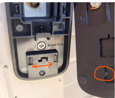

I also noticed on the mounting plate there is a tiny little switch type thing on it under the bottom bracket part which you can push to the right and it springs back. Not sure what that is for.

My AD410 is installed correctly. It slides down on the bracket and firmly clicks into place as it should. There is no question about that.
To remove, it slides right up and off easily with very little force. The little spring-loaded lock on the base can be moved back with the thin pin, but it isn't needed. It gives way without it.
From this image, you can see how it is supposed to work. The trigger lock moves back when slid down and clicks back on the flat edge . It's not clear to me why the trigger isn't holding in place for some of us, other than to say these thin plastic pieces are such a poor excuse for a lock.
