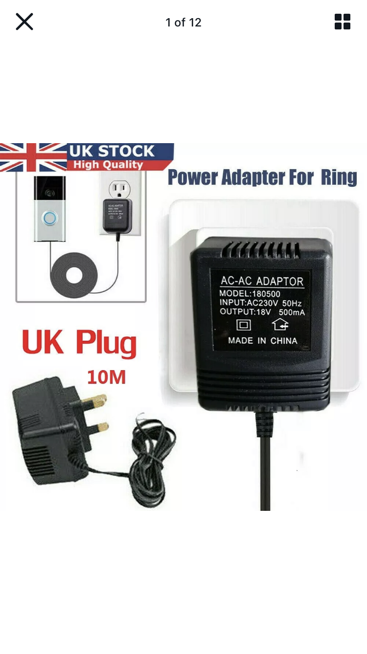

Thanks for the reply and welcome. To be honest much of what you say I don’t understand. I understand the voltage and ampage requirement but not sure how to know what va is on the supply (I’ve attached an image of the plug-in transformer I’ve bought - 18v 500ma.

Ok well here is the issue.. 18vac and 15-24va is Volt Amps. That is because most time when dealing with AC voltage it works in VA AKA Watts.. However in buying a Supply like your showing there that is showing the MA and anything in MA is under 1amp.. So if they were to write that correctly it should read.. 18vac 9VA aka watts.. So now I can't say to be honest seeing I don't know how the Indoor Chimes are in your area however over here the Smallest kit one would buy from a Big Box Store like Home depot or something like that would have a 16vac 10va and connecting that to a Amcrest Doorbell without upgrading the Transformer to at least 30va or 1.875amps will have some type of issue. Might be able to get away with a 16vac 20va aka 1.25amps...
So when someone buys the Power supply in your picture above that is so they can just connect that power supply to the doorbell camera without having a DING DONG bell inside because that most times wouldn't be enough to power the doorbell here in USA anyway...
Also hate to say it most all other cameras on the market for Doorbell cameras take less power then the Amcrest cameras... Most of them require as little as 20va and to be honest not sure how they can say that when some Doorbells inside require that it self lol.. But that is what I have seen..
Like that picture shows.. Power supply to outlet to doorbell camera nothing else connected however the Amcrest Chime Kit is still required, It isn't a CHIME that little white box it makes no sounds unless your cooking it lol

So if I read you correctly I would be best placed to purchase a 18v 1.5ma or (2a) AC transformer? I am trying to buy plugin versions for both the Doorbell and the chime (is it better to buy a wire in transformer?). My biggest problem is finding a chime kit that works in the UK.
