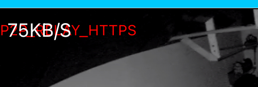

My apologies if this is already posted but I noticed recently that when viewing the live feed of the doorbell thru Amcrest Smart Home app it says P2P_RELAY_HTTPS. What does this mean?
- IMG_8152.jpeg (66.48 KiB) Viewed 69115 times

Hello and welcome to the forum.
Wonder if ot might be a mesh thing or something from your router? I logged into mine from local wifi, then cell connection and even added it to my AVP app and none of them said that

After I posted that I didn't ask but what Device are you accessing SH App on? Wondering if it might be a iOS thing?
Re: New AD410 Doorbell!
It also started doing that on mine after I updated the app.
