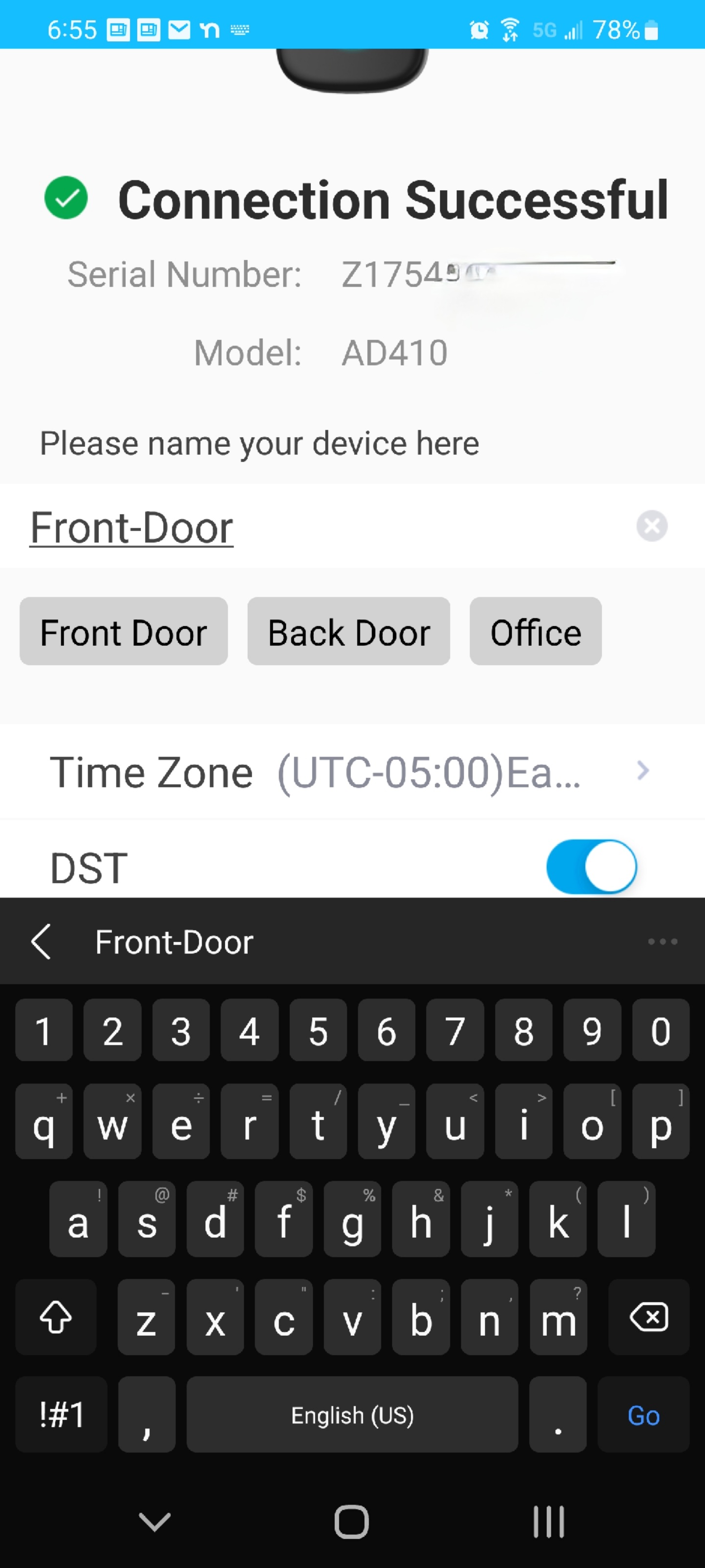

Ok Sorry it really kind of sounds like that it might be either broke or used and needs to be Reset...
So I just Went and Reset mine.. I am not sure if your cover came off however on mine when I tried to remove the cover to get to Reset/Micro Sd Slot the cover came out. So I removed it from my Smart Home App first, I then Press the Reset button. While I can't find the Key right now I used a 18ga Brad Nail from my Air Brad Nailer, After pressing the button feeling the button click if you will.. I held it maybe 10 to 15 seconds I didn't count sorry, The Doorbell then said it was Resetting. After it Reset and came back online it said Hot Spot Enabled. I then went to App and pressed the + adding it back using it's ASH-xxxxxxxx Hotspot. If your cover is off it is the smaller of the 2 holes for Reset, When you press in that hole if it isn't straight on you might miss the Micro Switch. Because of the Brad Nail I had to angle from center of camera toward the outside and not really straight in. You will feel the button push in. Just hold it there until it says it reset..
