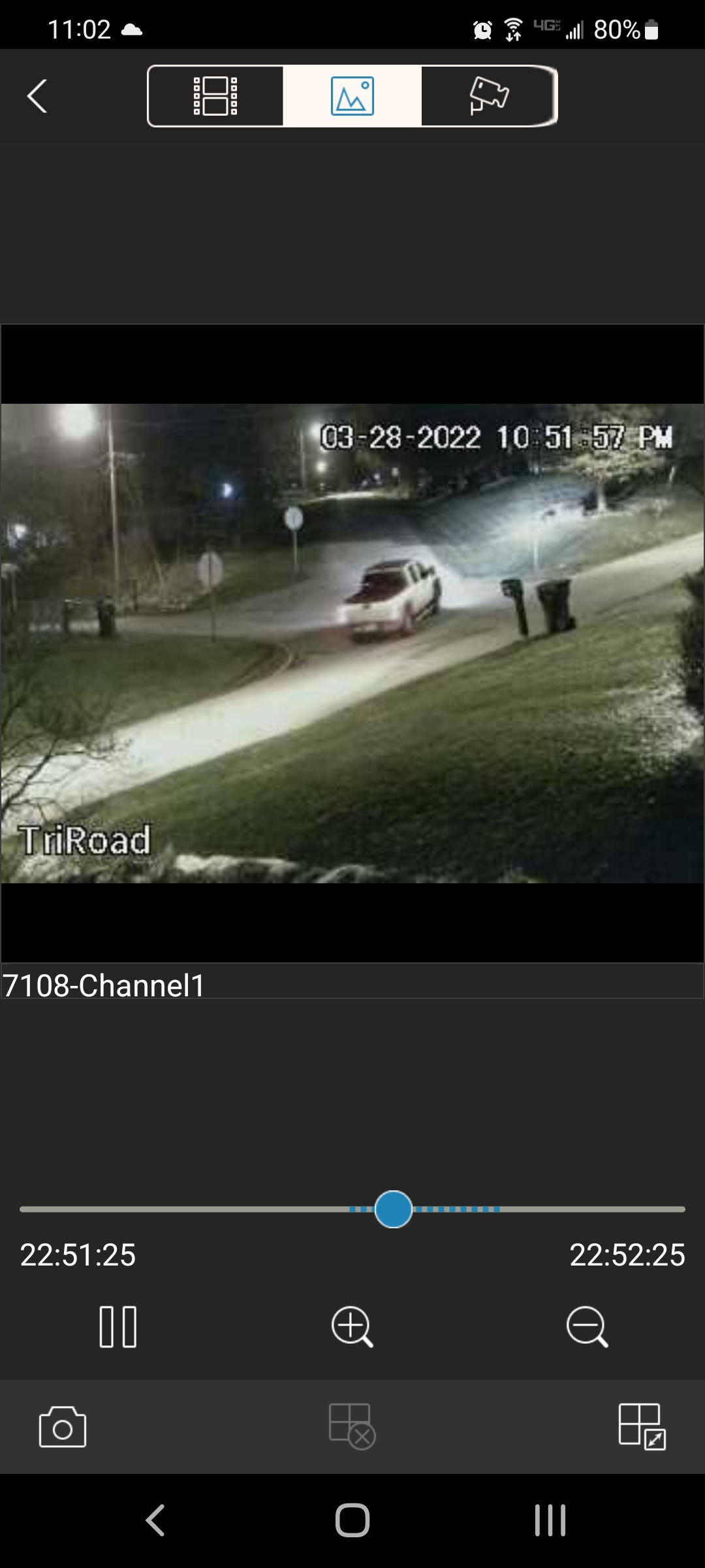

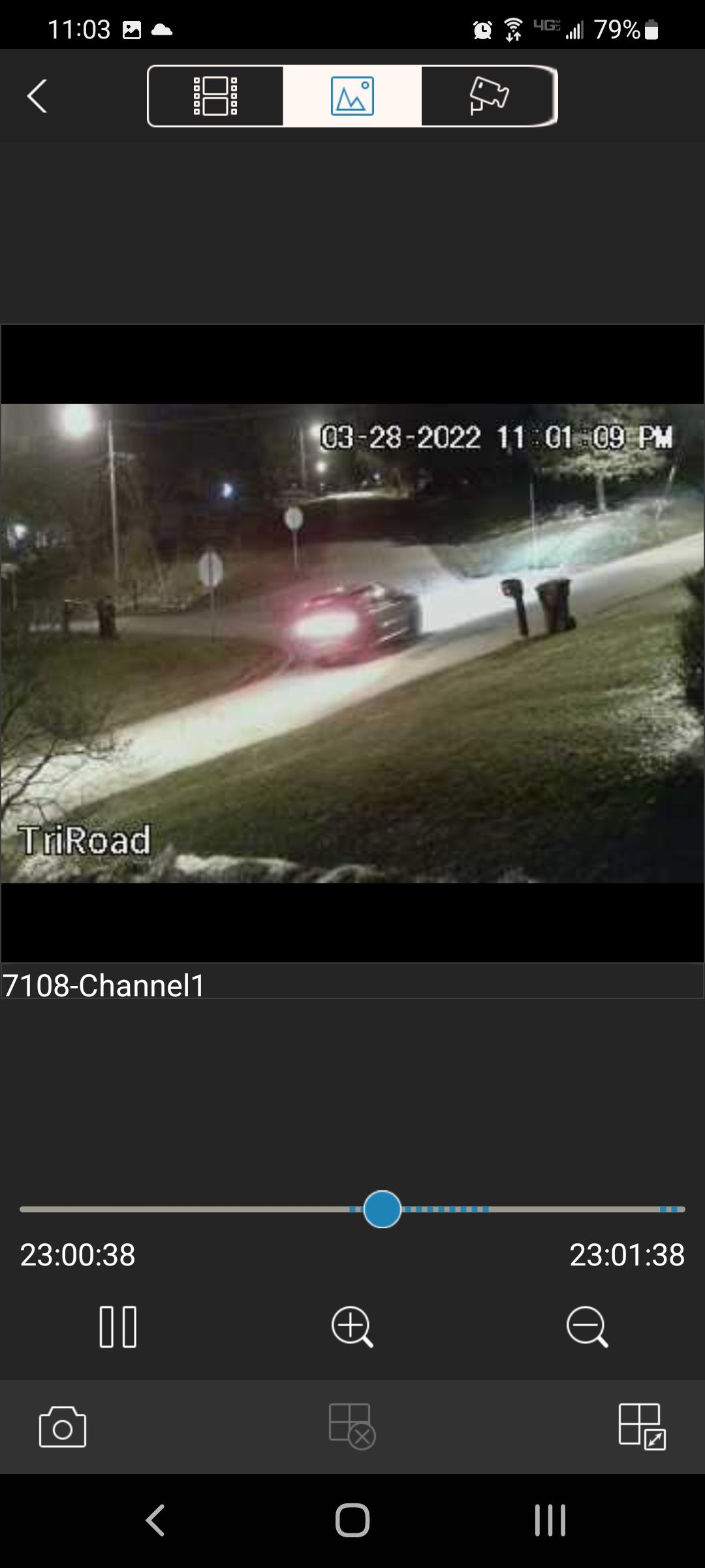

Also so I am clear I have tested with my Samsung S 21 Ultra on my Wifi and on my Cell data. Picture below is with my Wifi on and my last 2 events from Amcrest View Pro App
