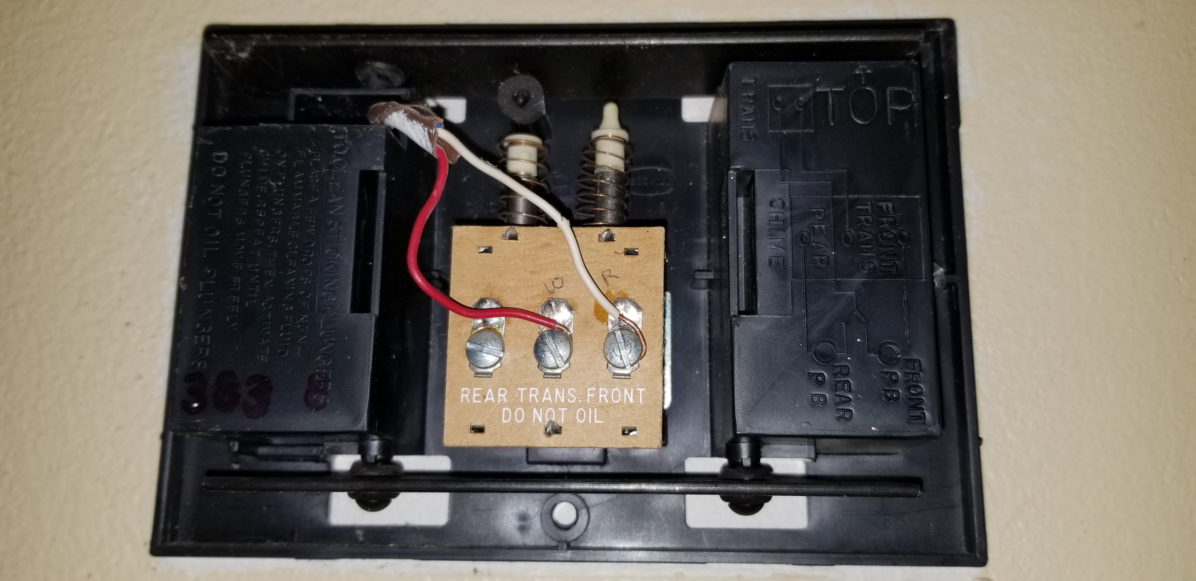

I installed an AD110 recently and was able to get it working after purchasing a new doorbell transformer.
I checked the output of the transformer at 16.2 volts, which was steady.
I checked the connections to the mechanical doorbell, and the wires at the front door.
I installed the digital doorbell ringer to test out the rings, but the family didn't like it and I went back to mechanical
However, I noticed the mechanical doorbell humming.
It isn't ringing, it's just humming.
I ended up taking the cover off because it was louder with it on, than off.
Could it be that this old mechanical door bell isn't compatible with the Amcrest doorbell? or maybe the new transformer? The voltage is normal and within the range suggested.
Doorbell hum

The mechanical door bell is a Model KB-10. I checked this online and it appears that the company that made it is either no longer around or they got bought out.
The transformer is a Class 2, 120v/60Hz input, 16vac/30va
So what you are saying is don't hook up the mechanical and wire it directly to the doorbell kit?

hi @digitalbeachbum and welcome to the forum. hmm... i think you should check the wiring diagram because the humming could suggest a problem with the wiring diagram. i also have a mechanical chime and i know it will hum if its wiring diagram is wrong. i know this because i had to remove my existing mechanical chime and cut out a small portion of its plastic chassis so i can neatly hide the included amcrest chime kit inside the door chime cover. i had a wiring mix up when i first put it back that resulted in the chime humming until i corrected the wiring.

I didn't do anything different. The mechanical chime is wired as it was previously.amcrest168 wrote: ↑Mon Jul 06, 2020 6:17 pm hi @digitalbeachbum and welcome to the forum. hmm... i think you should check the wiring diagram because the humming could suggest a problem with the wiring diagram. i also have a mechanical chime and i know it will hum if its wiring diagram is wrong. i know this because i had to remove my existing mechanical chime and cut out a small portion of its plastic chassis so i can neatly hide the included amcrest chime kit inside the door chime cover. i had a wiring mix up when i first put it back that resulted in the chime humming until i corrected the wiring.
Re: Doorbell hum
So what I would do is While it might be a PITA please remove the Doorbell camera and touch the 2 wires together and make sure that your NuTone KB-10 is still actively working right... It may cause a small spark but nothing to worry about unless you have a gas leak or something waiting for flame...
Sadly it is hard to tell what is going on without seeing the install first hand.. I have owned a Ka-10 and the KB-10 and only one ever hummed was the Ka-10 when the plunger got stuck.. a couple of things I would try...
One move the connection to the back door pegs and see if it still hums... Sorry it has been a while since I have seen the 2 doorbells so I can't remember if they were front and back I am sure they were... Anyway the other thing I would do is test the doorbell without the camera installed to make sure it is working as it would if connected to a button..
Also CHIME kit installs on the doorbell T and F pins along with the 1 wire for the camera and the other wire for the Transformer... T wire goes to Transformer, F wire goes to one side of the doorbell camera the other wire form the camera goes to the Transformer however that wire should have already been run when using the normal button that was there before...
However if the wires were to small or damaged in installing the system this can make things not work well also..

hi @digitalbeachbum, the picture you shared should be the 'before' wiring diagram--before the ad110 installation. can you show a picture with the amcrest chime kit installed on the chime? the included amcrest chime kit must be connected to the mechanical chime for it to work properly.

Do I need the chime kit if I'm not going to use it?amcrest168 wrote: ↑Tue Jul 07, 2020 7:11 am hi @digitalbeachbum, the picture you shared should be the 'before' wiring diagram--before the ad110 installation. can you show a picture with the amcrest chime kit installed on the chime? the included amcrest chime kit must be connected to the mechanical chime for it to work properly.
Re: Doorbell hum
The CHIME kit is needed for the camera to work right... There is no chime in it it is called Chime kit because it is a Circuit that goes on the Doorbell unit or chime unit inside the house... But yes the Chime Kit needs to be used even without using a doorbell..
