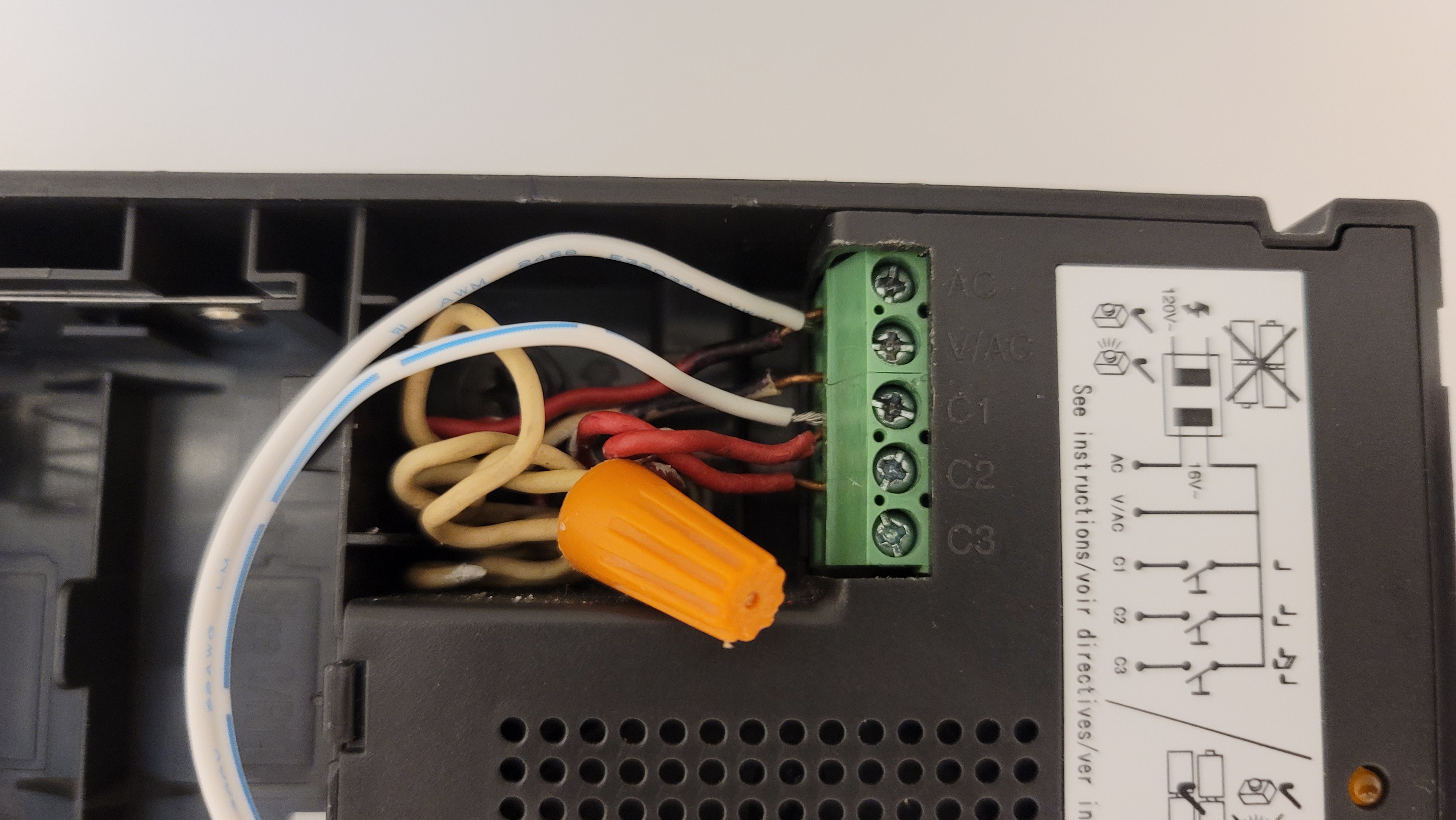

Thank you for the info. I was going to try the testing and noticed one of the door chime kit wires was sliding out. I tightened the connection and both doorbell cameras seemed to be working. Both front and back chimes would ring and I was able view video from cameras using the same connections. Later that day, I noticed the back door camera lost power, went offline and lost wifi connection. I checked again a few minutes later and it was back online again. Later that evening, I noticed again the back camera had no power. I thought it was because the front camera was using too much power after we came home from grocery shopping by making several trips back and forth from the car to the house at nighttime, causing the back camera to lose power. This time the doorbell camera would not go back online. I removed the doorbell and tried powering it through microusb and powered up fine. I tried connecting it back outside and it wouldn’t power on. I tried hard resetting the doorbell and reconnecting outside, but it still wouldn’t power on.
I had some time today to try some tests. I disconnected the back doorbell camera and chime kit, tested the front doorbell and it was working fine. I then disconnected the front doorbell camera & chime kit and installed the back doorbell camera and chime kit on C2. The doorbell would not power on. I tried changing the chime kit by using the front door chime kit instead and it still did not power on.
Right now, the front doorbell camera works fine after separating both wires from C1. Wired: 1 wire in AC, 1 wire V/AC, 1 wire C1, 1 wire C2, with the door chime kit in AC & C1 (attached is a photo).
I tried re-installing the back camera with chime kit in AC & C2, but still would not power on.
I’m not sure if the electrician wired the door chime a special way where both wires (C1 & C2) need to go together in C1 in order to power the back doorbell or if there might be an issue with the doorbell since it was working before.
- 20210914_182426.jpg (2.11 MiB) Viewed 5903 times

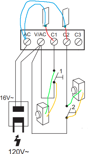

I am not sure how they have your system wired and that is main issue... From what I have seen of that doorbell Chime.. AC and V/AC need to be connected to the 16vac Transformer... Then the V/AC side goes to 1 peg of the Switch (Doorbell camera now) the second peg goes to C1 Then the second doorbell should be wired the same with V/AC going to 1 peg of the Switch (Doorbell Camera 2 now) and the second peg of the camera goes to C2 Then there is as you have it now with the Chime Kit One wire (White ) going to AC and one (White Blue Stripe) C1 and the other would be same however White and Blue Stripe would go to C2 that would be with the camera wire being connected...
So I did the Diagram again.. This time Reflecting what it should be like. I left the Switches where they were on 1 and 2 and connected the cameras to the wiring that is showing Open Switch (Open Switch would be the Cameras PEG 1 and Peg 2) Then Chime kits are above with 1 wire
