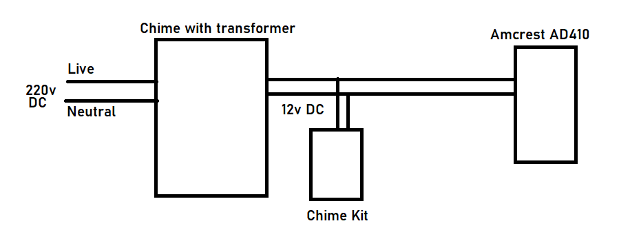

Would this work?

Another thing to mention, looks like doing a wrong wiring with the Chime Kit could burn the AD410. So I'm thinking it may be a better option if I just use a wall wart as you mentioned, and since I'm already setting up HomeAssistant (I chose this doorbell because of amcrest2mqtt) I can use that events to notify or ring some chime using a smart module.
Let me know your thoughts :)
Re: Connecting power to 220v/12v chime?
Sadly the Chime kit is designed to work with AC voltage of up to 24v and to be honest 16 is best bet. So in your last post would be best option for your location.
