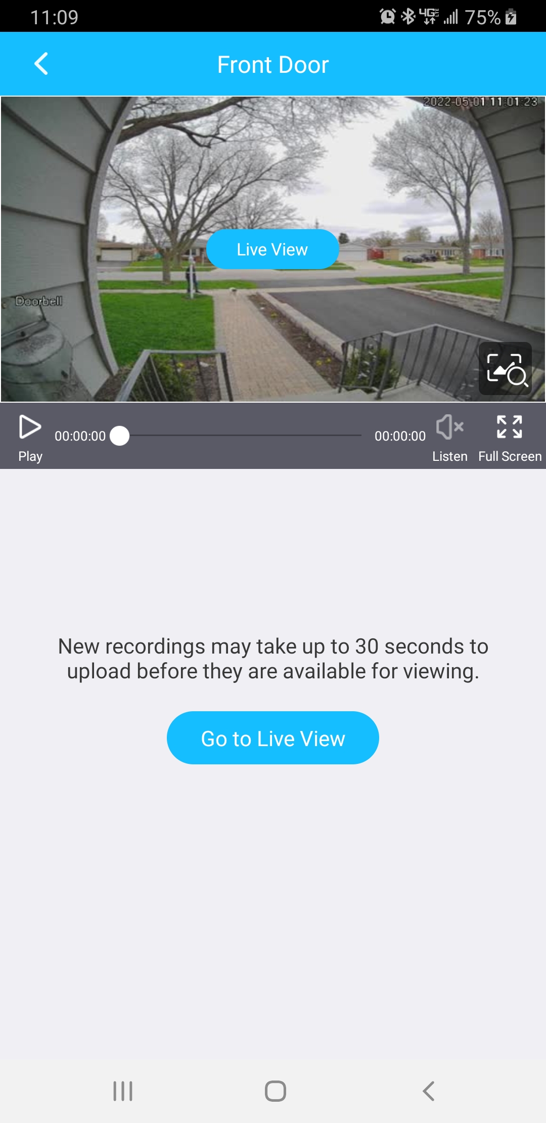

2nd question. With the Nest Hello doorbell camera, when someone came very close to it, it would email me an alert. The AD410 seems to pickup everything in front of it even with sensitivity set low.
3rd question... When I get an email alert of detecting someone, my Nest would send me a snapshot of the mailman, visitor, intruder. My AD410 sends me a picture with "LIVE" smack in the middle of the picture, blocking what may have triggered the camera. I do not want to go to Live minutes later cause the person is Gone. I want to see a snapshot like Nest did of who triggered it. How do I get rid of the LIVE offer which does not good when they are gone.
Screenshot_20220501-110939_Amcrest Smart Home.jpg (451.33 KiB) Viewed 2634 times
