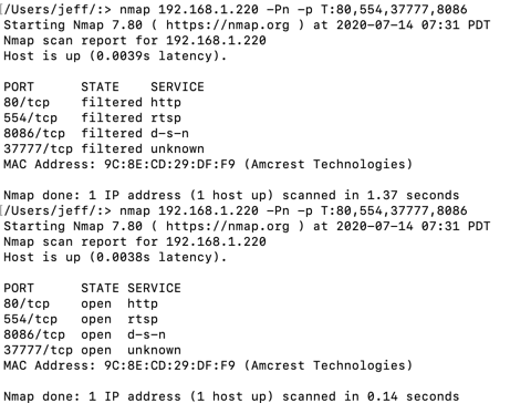

I can confirm this MAJOR BUG. What a drag. I just bought 5 of these and will have to return ALL of them. They won't even connect to the Amcrest NVR's which I have 2 of, not to mention any home automation systems like home assistant.
Here's proof. Nmap #1 is with the ethernet cable unplugged. Nmap to the SAME device with the ethernet cable unplugged and all the ports close and are unavailable. WTF? are these engineers really that lame? This is about as basic as it gets. So much for their claim "The most advanced camera ever produced by Amcrest". False advertising for sure.
Any Yes, I'm on the "latest" Firmware which appears to be April of this year. And Yes, I used Wifi ONLY setup. I've tried pretty much everything, all setup methods, and regardless, the same behavior from the Wifi connection ports. Unplug the ethernet and all wifi ports are FILTERED, meaning not working. Plug it in and they work. Lame.

WOW ok now I see what is going on.. I just reset mine and set things back up and now find that mine also is the same as listed here Where I was able to connect to my NVR on Wifi I no longer can after setting up.. Plug in all ports open and even though the Camera Ip I try and access on Wifi only (didn't connect) once plugged in not changing IP leaving it on my Wifi IP it connected
So I have sent this off to Amcrest and this thread Link
