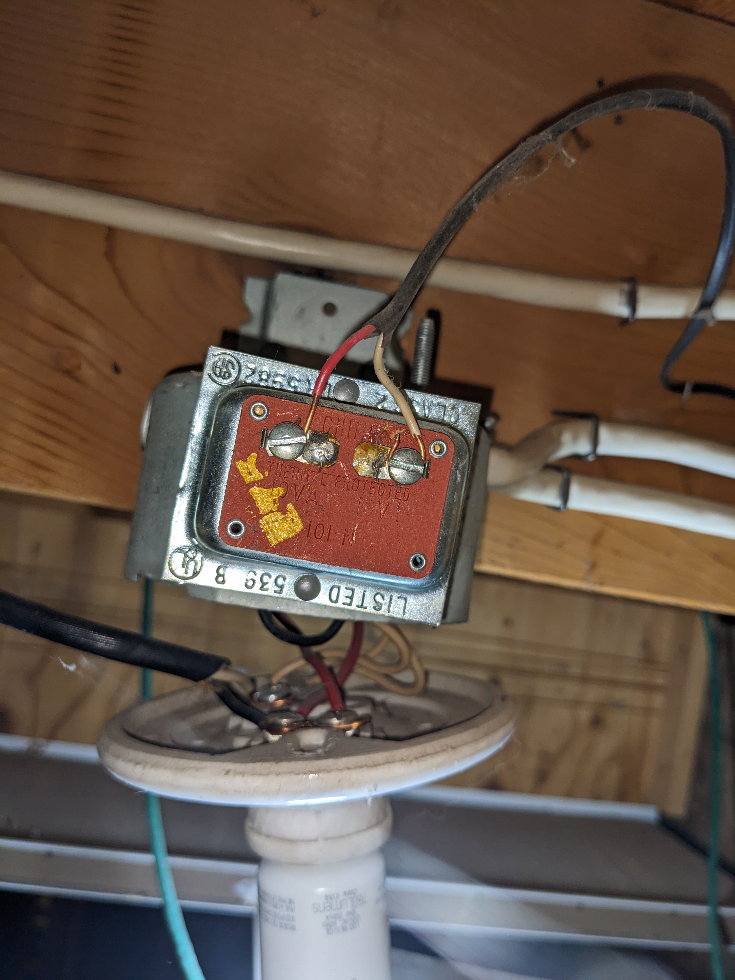

This is in a likely spot in the basement lighting at the bottom of the stairs down from the front door. The wires head off in the direction of the doorbell. Although since it says CHIME there I guess the intent is for the wires to go from here upstairs to the chime and then from there to the doorbell switch?
I've always had the impression that the previous owner did most of the basement himself. (although it was me who replaced the light bulb and didn't improve the situation)
Re: App not finding AD110
Well as I expected that transformer says 10va on the side so that is an issue where the system is causing your doorbell chime to act funny. After doing some of my own testing and I have not moved over to doing any with my Scope yet, However I found that with the undersized transformer what is happening in my case anyway is that the Transformer ramps up and dumps under voltage over current and that is what is making the doorbell ding faintly. However for some people the chime is low enough voltage that it makes it ring constant as it is doing the up and down cycle of the current and voltage..
