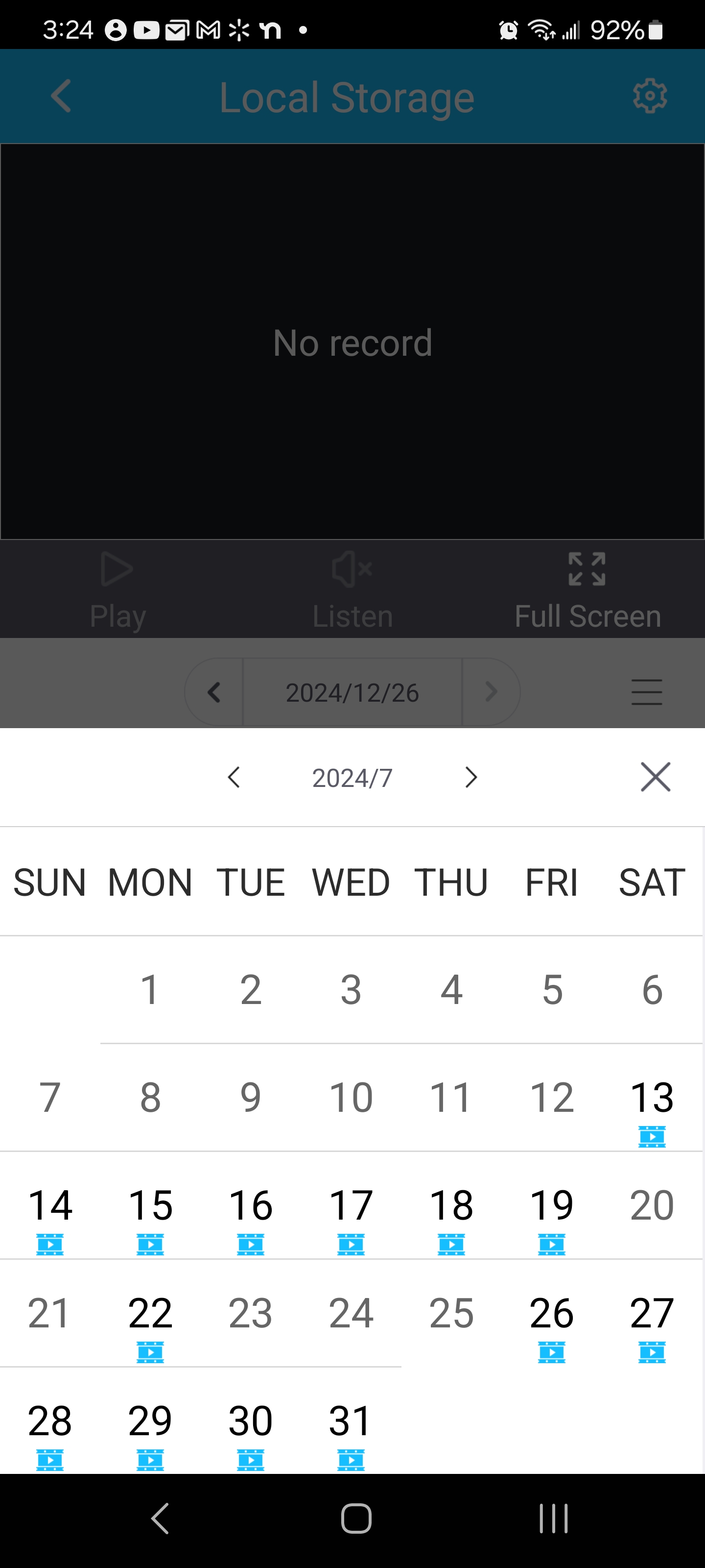

Re: Amcrest Smart Home Camera Cloud Recording Playback Error
So something to try. Click on the Smart Home app, Then click on one of the cameras you want to view. Then in there click on the Micro SD card.. If it is Cloud Recordings then don't have anything there seeing I don't use the Cloud service.. However if SD card then click that and go to the day of the event and it should pop up the place holder for your event.. Even with the app being removed and added back all my recordings are still in my SD card and able to access them going all the way back to July still..
Screenshot_20241226_152427_Amcrest Smart Home.jpg (344.52 KiB) Viewed 14985 times
