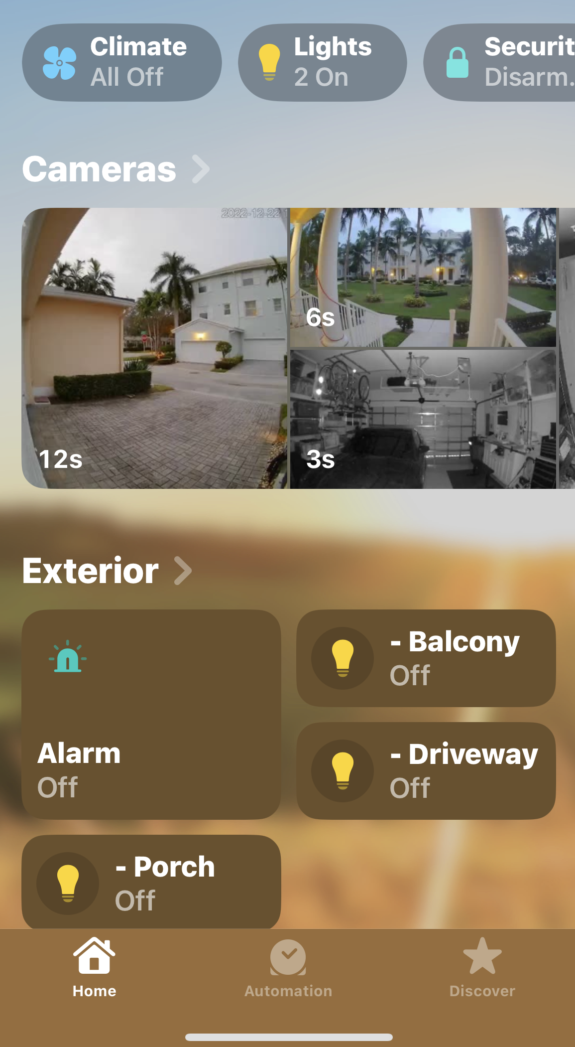

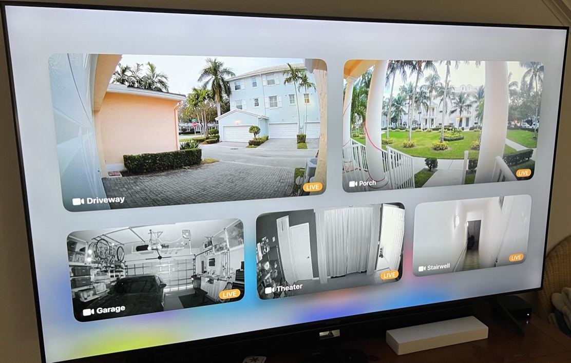

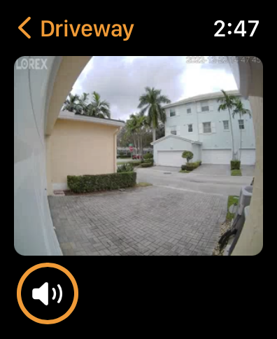

I have the Lorex B451AJ, which is the same as the Amcrest AD410, but perhaps slightly different firmware. I am running a Ubuntu Server VM and homebridge-camera-ffmpeg v3.1.4 plugin to allow me to view the RTSP stream on my Apple devices (iPhone, ATV, AW, Mac) via the Apple Home app. Works amazingly well.
HOMEKIT INTEGRATION
I would like to receive notifications when my doorbell is pressed and answer the doorbell from my iPhone or Apple Watch via HomeKit. I already have an adjustable current sense relay in series with my transformer that triggers when the solenoid on the mechanical chime actuates, which is monitored by my home security panel and lighting controller.
