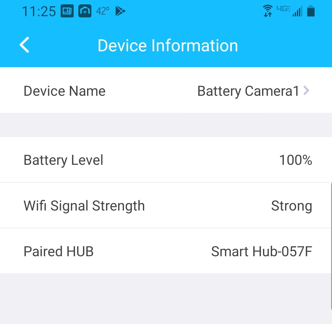

I have the camera setup and running and been testing for several days now. Though the camera sits inside the house where there is no motion. I checked the battery 2-3 times day via the app just to see how good (or bad) the camera is in terms of power consumption. What I notice is it uses 1% per day with NO motion. So at 100% charged, in theory it will only last approx. 100 days. No where close to 6 months. That's for sure. Now the reason why I haven't mounted yet is because I may consider returning it if it only gives me 4 weeks of use. I don't want to charge it every 4 weeks. This is NOT good enough. I understand there are many factors that can influence power consumption. Even a camera with 10,000mAh will not get you 6 months!
Re: Amcrest Battery Operated Outdoor Camera
Sadly not sure camera has been wired also the location its in is high traffic so no telling how much time I would get.
SmartSelect_20210403-112517_Amcrest Smart Home.jpg (116.41 KiB) Viewed 5285 times

So yeah I am not sure as I was saying it would be hard to gauge what one can do over another.. I left mine on Battery today and as you seen before it was at 100% and now it is on 94% so that is a large jump.. Battery life is another thing. Your camera is new and to be honest it might need a couple Discharge and charge cycles to know for sure how something will act. I mean sure they are not NCAD or NMH type of batteries and should give full out of the gate on first charge however at times I have seen some that had some issues with charge because of memory loss.. Should be close to fully discharged before charged or life could go short.. Personally I don't know the true state of my Battery it has been Powered by cable and not on battery until today..
So today looking at my Battery I am down to 90%, was about same amount of traffic on motion as day before..
