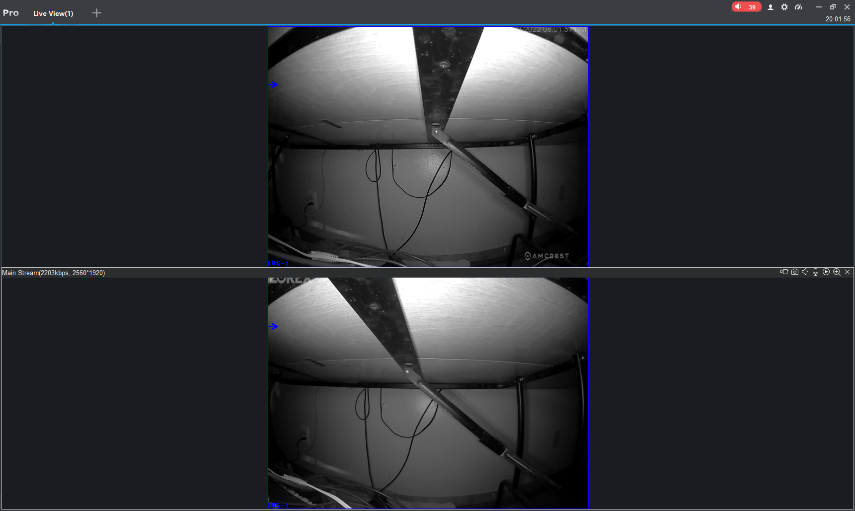

So I reset both of them back to factory. Oddly the Lorex starts out in 1440x1080 and the Amcrest starts out in the Highest. So I did change them both and Lorex has HDR turned on Amcrest had the WDR turned off. It is now on. So they are both in the same 2560x1920 with HDR and WDR turned on.
Truth be told
Let you decide. Keep in mind that the Lorex can't do all the things that the Amcrest can. However the Lorex has some features that are missing in the Amcrest but could easily be added within the firmware. The features that are in the Amcrest can't be changed in the Lorex FW to support it because while the 2 Doorbells do look alike the Hardware inside of Amcrest has better circuits for all the high end add on. That is why the Amcrest could have the features of the Lorex but the Lorex won't support all the features of the Amcrest it isn't in the Circuit board of the Lorex..

Hi Revo,
"Truth be told" ??? Not sure what you meant by that, but your post brings up many more questions than it answers as your comments lack any specific examples of any feature or hardware differences. The accompanying image showing nightvision PQ doesn't really show anything different either that I can easily see.
I would be interested in learning exactly what are the "better circuits for all the high end add-ons" you mentioned as I thought the circuitry & camera were identical.

About my Take on the quality of the picture above. There is clearly some Quality differences between the 2. What one might find a clear quality difference between the Amcrest might feel that it is a flaw and say that the Lorex has better picture. In truth the Detail for me is what is important. One camera clearly uses some type of software to try and clean up the quality of the Picture. Doing so does make it look cleaner. However I like true less software cured picture for better definition.

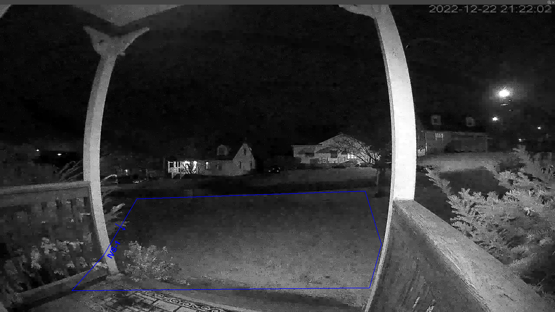

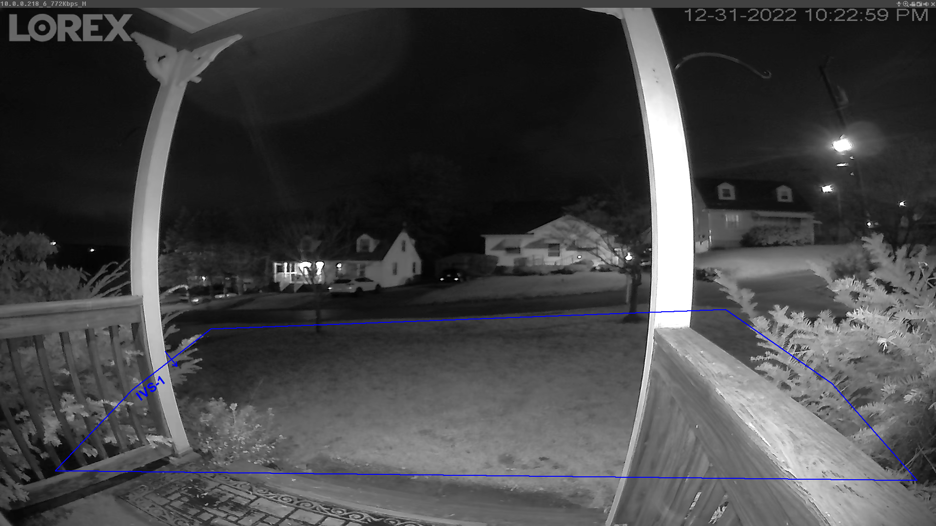

Also right now I don't have the Amcrest outside for a true side by side. However here is a picture from the Lorex tonight and Amcrest a few nights ago around same time of night a picture from Playback. I know that it says 21 hours but I didn't see that it was running an hour behind like it likes to because the picture quality of the time stamp don't show to well. Some reason the 4108E-HS on older FW don't like to keep the cameras time upto date as well as my 4216E-AI, 4116E-HS, and others on the newer FW.
Amcrest Ad410 with IR on.

Lorex 2k Doorbell with IR ON. In the same mount the Amcrest it connected to.

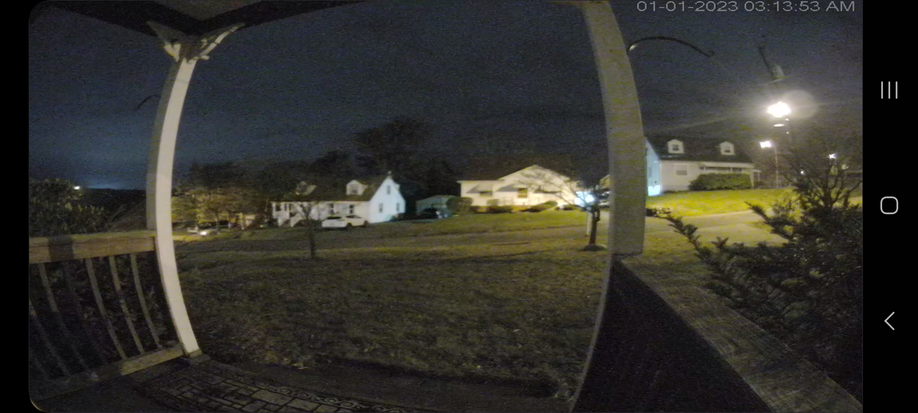

Night color
