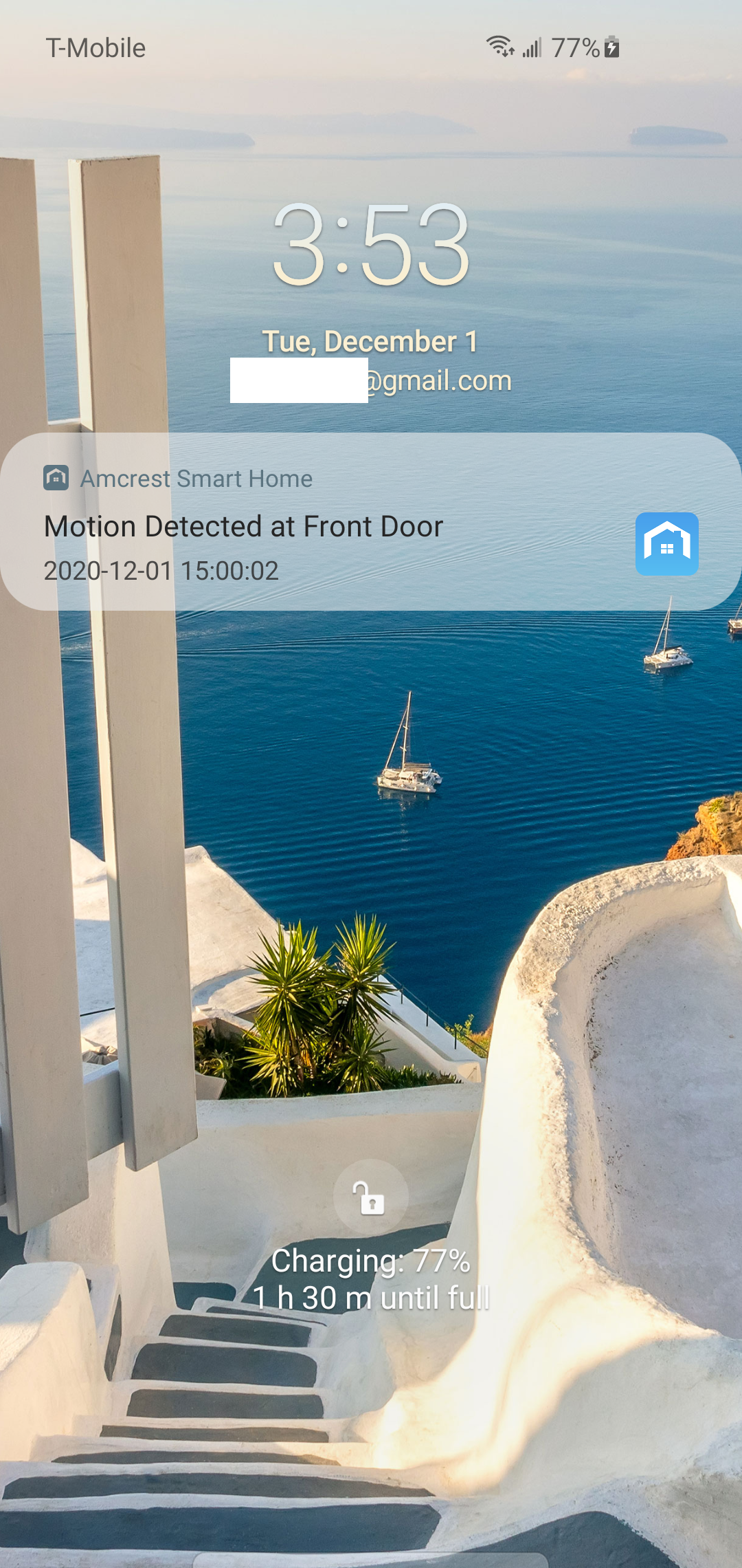

Hi,
Just installed my doorbell camera and am liking it so far!
The only thing in my wishlist right now would be getting an image in the motion detected notification. Right now its just text (see attached). To see who/what it is you have to:
- click on the notification
- unlock your phone
- the app opens to the clip, but you then have to manually hit the play button for the video to start buffering
I also have Blink XT2 cameras and the notification you get from these have an image in the notification. Typically that's enough to know if it's my wife walking the dog or the FedEx guy and no need to even view the full clip.
2nd on the wishlist would be to just auto-play the clip if I click on a notification
