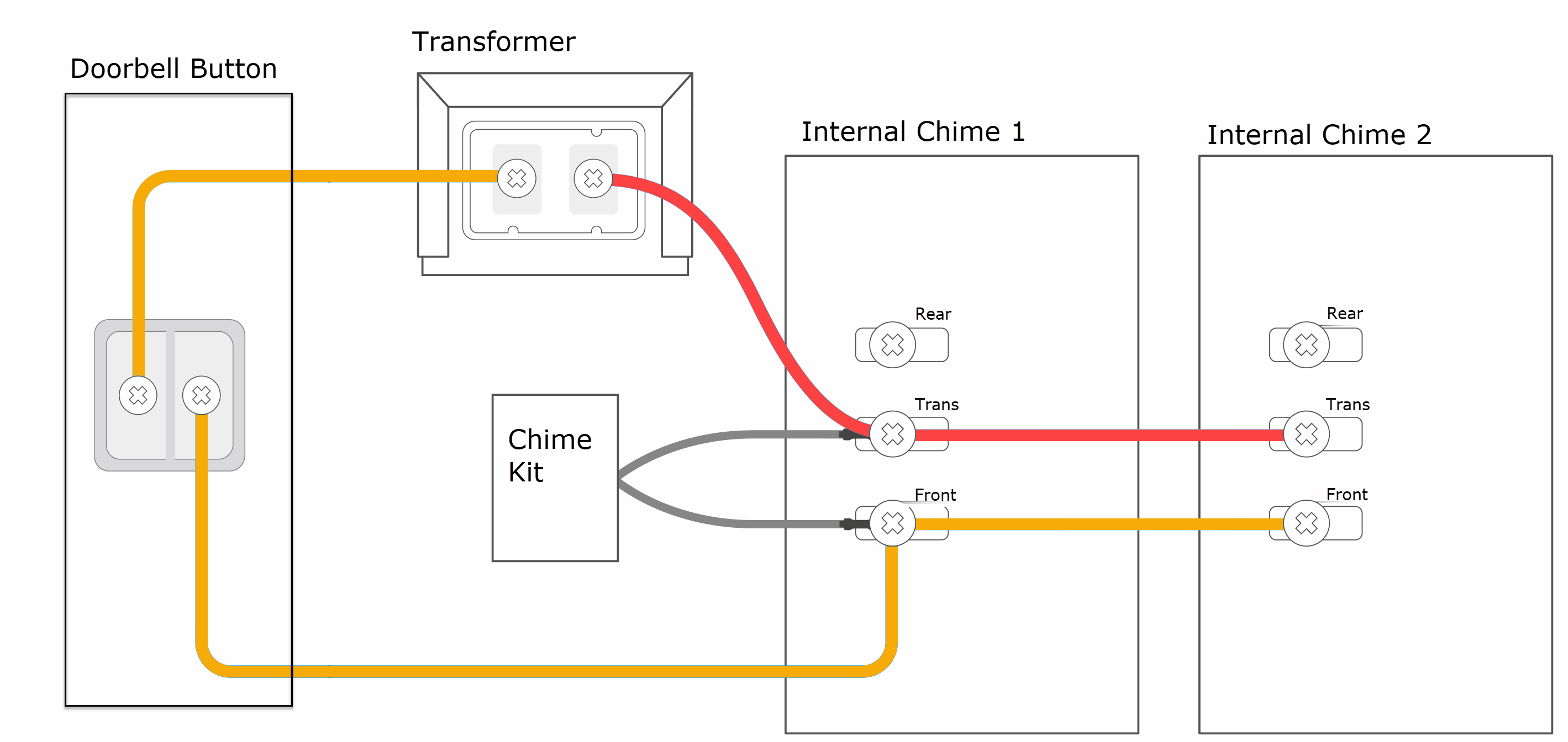

OK, it looks like my house had a couple issues that I had to address to get the AD410 working properly with two chimes.
1) My transformer was only 16V 10va. I replaced this with a 16V 30va transformer.
2) The electrician had wired the two doorbell chimes in series instead of in parallel. (I think they may have done this to get away with using two chimes on an underpowered transformer.) I traced and identified all the wires and re-connected them as transformer--button--chime in series, and then the second chime in parallel with the first chime.
So the correct way of wiring it appears to be like this:
One must install the chime kit before powering on the doorbell. Then select the mechanical chime option in the Amcrest smarthome app. Then one may test the doorbell button to ascertain whether the mechanical chimes work.
After making those changes my AD410 doorbell appears to work properly, ringing both indoor mechanical chimes.
