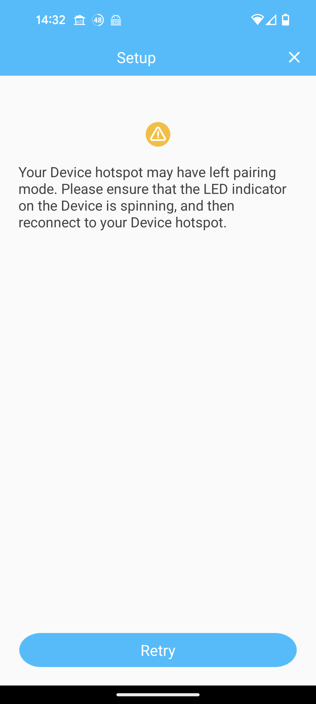

Using the Smart Home app I cannot get it to pair -- either on the original connection (as a doorbell) or with the USB connected on my desk.
I've tried shutting off ALL but one SSID on my WiFi (I have four, two on each of 2.4Ghz and 5Ghz) with no change and even took a second phone (Pixel 8 and 6a) and set the 8 as a hotspot, connected the 6a to that, and then attempted to pay from THAT device. Nope.
It sees the "temporary" hotspot, SAYS it connected to it, and then spins and times out with this:
It most-definitely has NOT left that mode; I'm looking at it and the button light is still spinning around. Several hard resets just to make sure, plus clearing the app's data a couple of times as well -- nope.
Is there a way to get into this thing via a web interface? That is, could I connect to the "hotspot" and then http (or https) into it and set it up THAT way? That would work, if I can figure out what it wants (obviously the app is using something kinda similar, I presume, to set it).... but there's no docs on any of that.

Serious..... I still have to do THIS?
https://amcrest.com/forum/amcrest-smart ... 23a9b33414
Yes, that worked. But seriously -- May of 2022 and the app is still not fixed?! Holy mother...... I'm good, but.... yeah, not good.

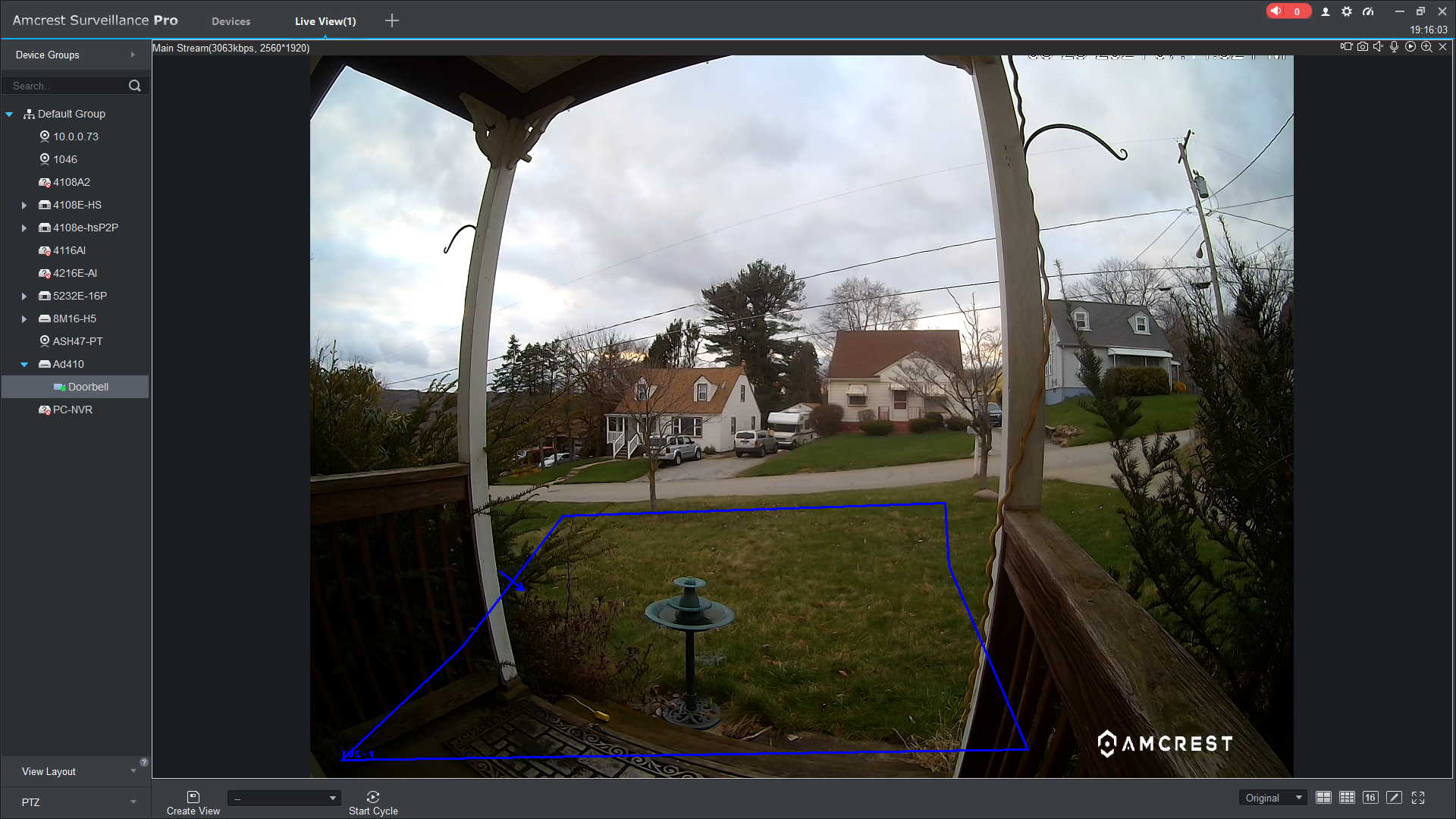

So if I had to guess the Doorbell camera has some hardware missing that makes it so other cameras with WebUI in a larger platform. Where the Doorbell is in a Compact design, Found out that the doorbell in fact can work at 30FPS even though it was designed and released on 15fps. My guess is to keep the heat down in the camera. Seeing at 15fps the camera gets really hot already. Then if you were to use camera in direct sun light even hotter.. So the design team thought ok lets keep the FPS down.. So again back to compact design, some circuit parts need to be watered down. This will keep it compact and able to work on RSTP, App, API, and can work on Blue Iris and or even ASP from Amcrest. So there are ways to be able to see the Live feed besides adding it to a DVR/NVR.. So it has many more options then some of the other Doorbell cameras that I own.
Smarthome is a Cloud based system. P2P that works as P2P and push notices to your phone app. Setup motion and or Human in the app and get instant notices that can be saved when needed from app. While it isn't 100% as robust as Amcrest IP cameras with all offered it is a lot better then so many others offered. The blue box is from the doorbells human notices setup and this is directly displayed on ASP and not first being streamed though a NVR. I could display it either way just wanted to show that it is directly from the AD410.. So there are many options again lot more then some other brands offered..

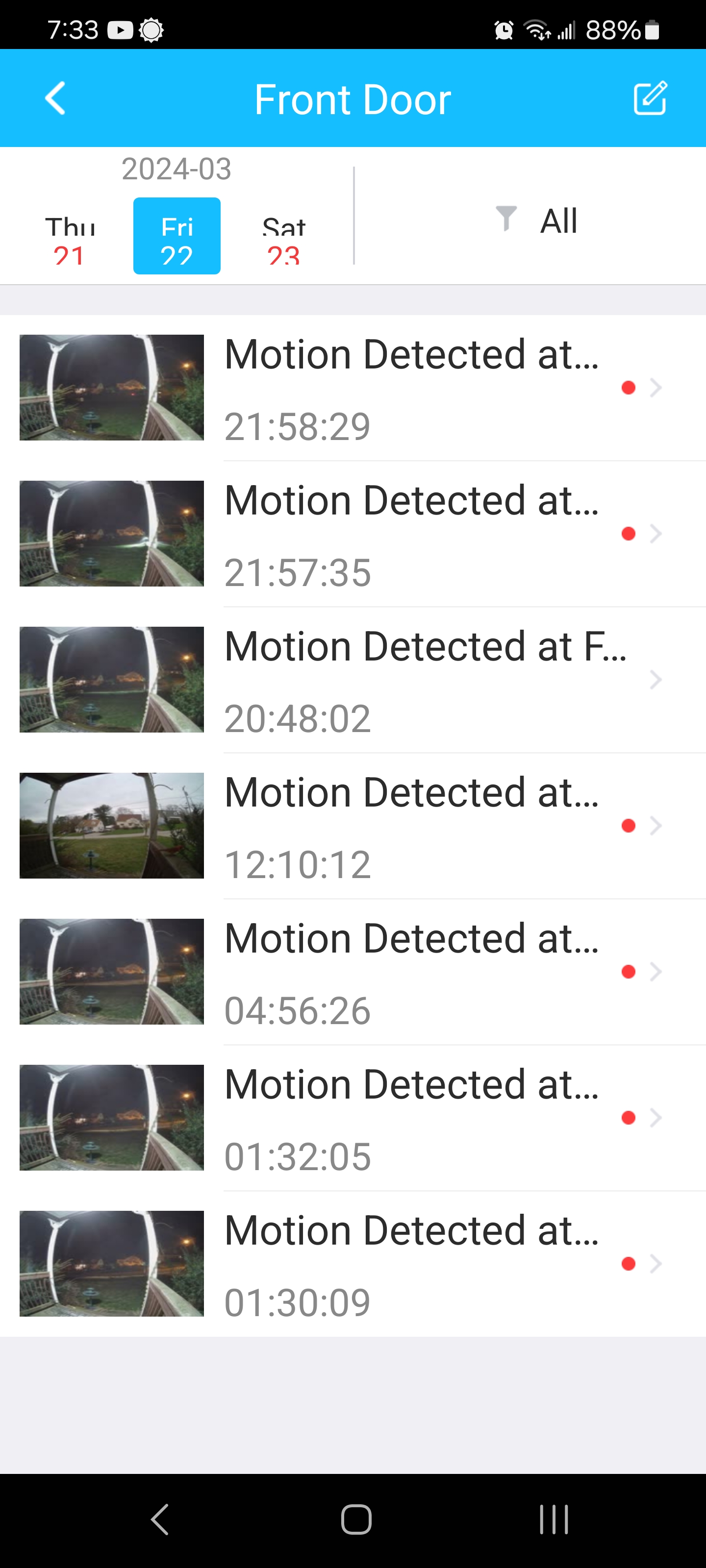

With motion option still enabled, can have setup for human only. So has some good options.
