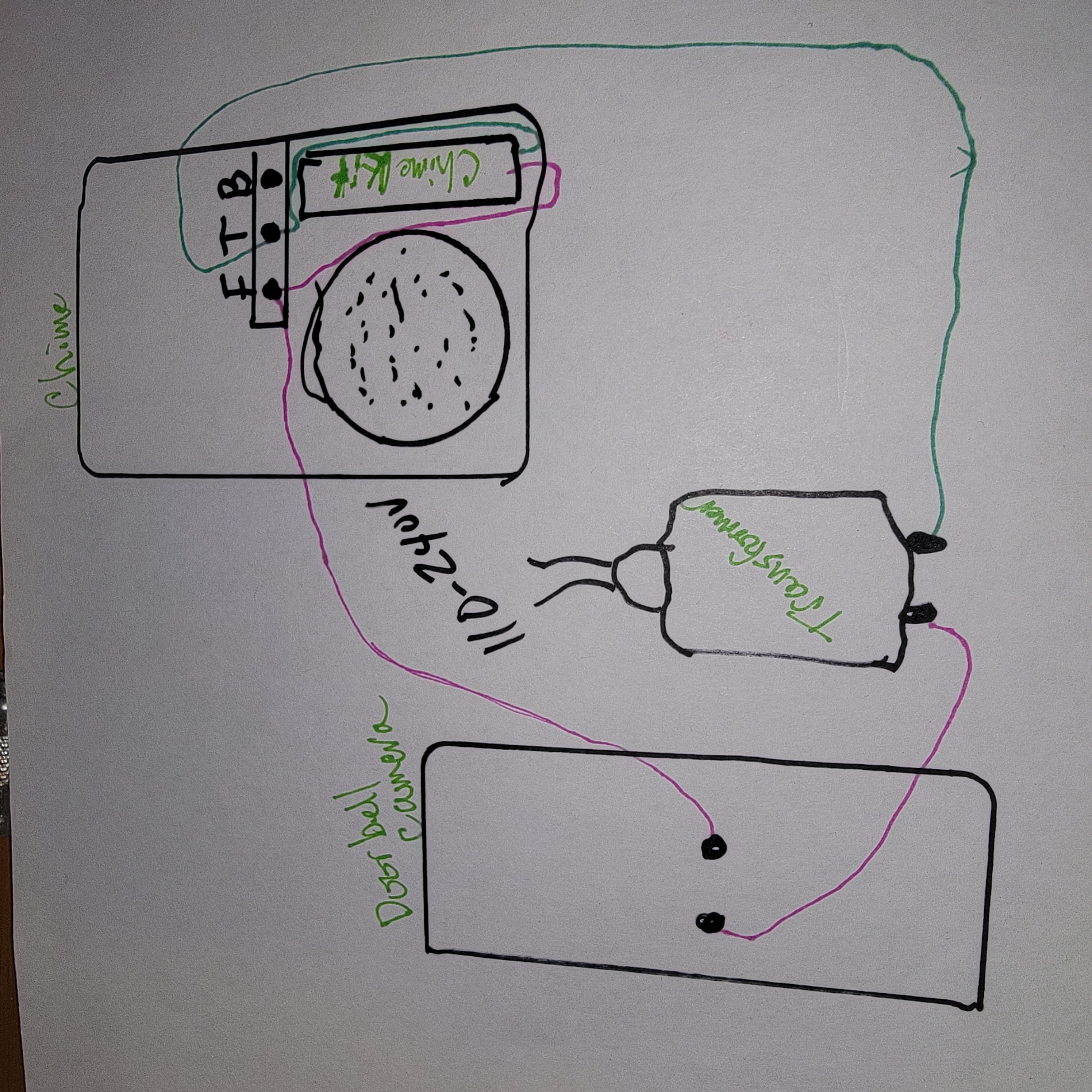

I installed an AD410 almost a year ago and it has worked fine up until recently. When I installed it I also replaced my old transformer with a newer 16v 30vac transformer. I also installed the chime kit. My doorbell is an older digital chime. Recently the AD410 started to reboot itself after each doorbell press. The voltage at the transformer is 17.5v while the voltage at the AD410 is 17.1v. When I press the doorbell button the voltage at the transformer drops to about 16.5v. Knowing that my old doorbell chime was not on the compatible list I replaced it with a Heath Zenith SL-2796 which is on the compatible list. The AD410 still reboots it self after each doorbell press. If I don't enable the chime in the app the AD410 works fine. Could something have happened to the AD410 or the chime kit ? I could replace the transformer but it seems to be working fine. Any help would be greatly appreciated.

So looking for more info. 2 Wires from Transformer 1 going to the Camera and 1 going to T on the Doorbell Chime, Then you have another wire from Camera going to F on the Doorbell Chime. Then you have the Chime Kit from Amcrest connected to T and F on the Doorbell Chime?
If that is how your system is/was setup then started having issues I would double check that your system is still within Specs, Length for Wire for Distance of wire isn't damaged or to long.
With the Camera setup without a Doorbell chime there is no need to use the Chime Kit, However it sounds like you want the Doorbell Chime to work and in that case an Chime Kit is needed again that is on T and F. Then where the Camera is connected there should be 2 wires, 1 from Transformer (Second wire) and the other wire goes to F
It could be that the Chime Kit is damaged however if that was the case when you remove the Camera from being used with a Indoor Chime there should be no issue when the Button is pressed because the camera no longer does anything in the back like it would normally when your trying to work it with your Indoor Chime..

Thank you again for the response. I believe your picture accurately represents my setup.
