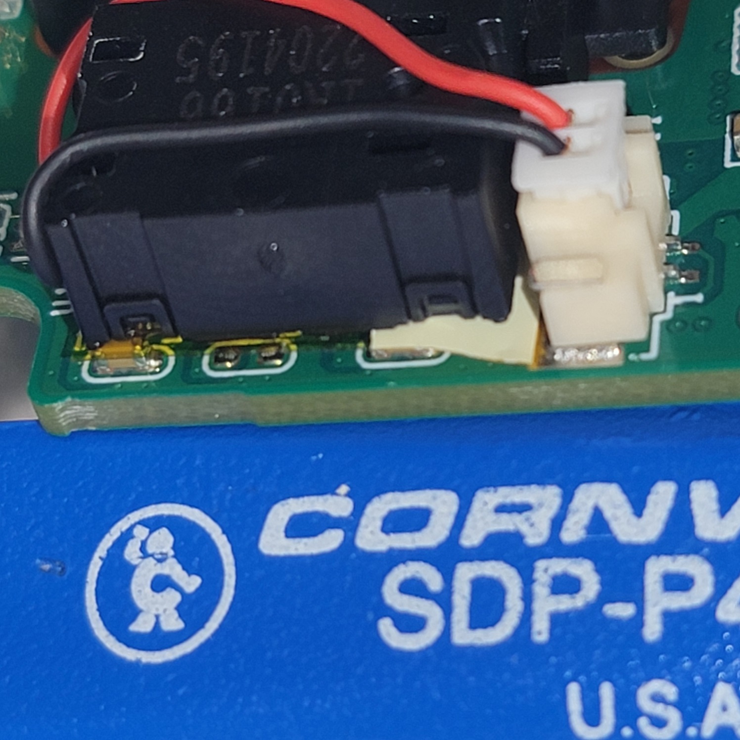

Before that I was wrong about what I thought I remembered seeing the inside and it only having 1 Cap on a pair of wires. I WAS WRONG. It's just like the Lorex 2k camera and infact has a battery.

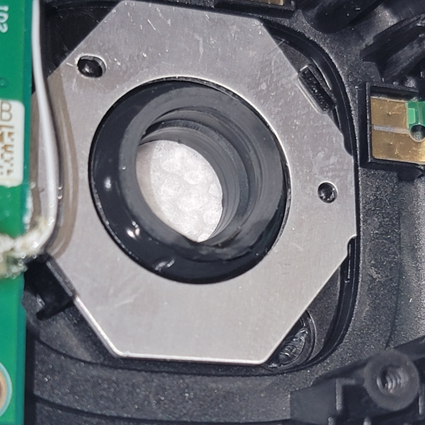

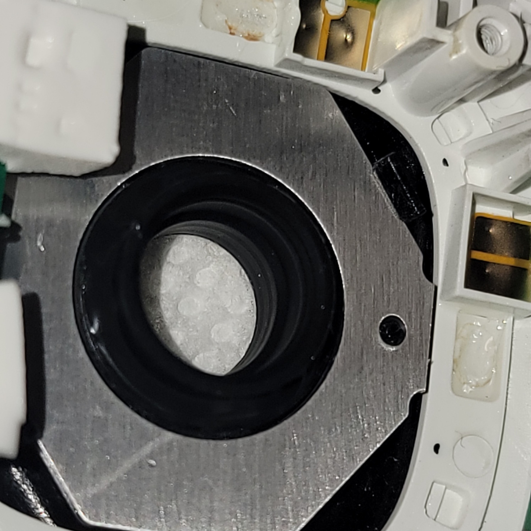

Taking my AD410 apart there is even in my camera an issue where the rubber seal is not placed right. It is also glued in place. So is the Lorex so I am clear, however even on my AD410 the glue is not placed well. Looking at it you can see it's pulled to one side of the housing.

Hey Revo - thanks for the teardown! Yeah, I was quite sure the build and all components were the same in both, but glad you confirmed it.
A potential rubber seal or camera lens misalignment was the key suspect in this. So you've confirmed the seal isn't sealed very well. I'm having a hard time seeing exactly what you seeing from these pics. I assume the lower pic is the Lorex (white case) and the seal looks even all around where it borders the metal octagon/IR housing.
On the AD410, I can see a gap in the outer ring, but I don't see how that would emit light into the camera lens which I assume fits inside the black rubber tube seal.

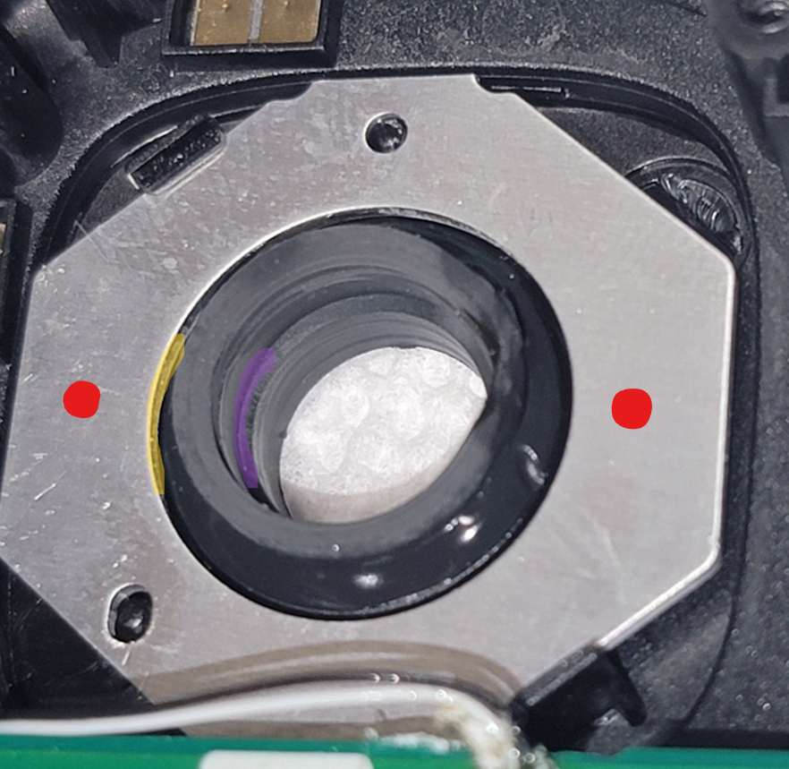

I've made a copy of your top pic, rotated to show where the 2 IR LED's are located under the metal plate. I've highlighted in yellow where I see a small gap. Is this the area you are talking about not being sealed? Or is it the purple area?

So in the area of the 1 Red Dot only is the area that I have that is pulled down from the glue. In the event other cameras were made with same type of issue and the lens is going though the camera it may be able to pick up IR because it might be fed through the rubber boot to far..
I hate to say it from what I see from both the Lorex and the Amcrest there is no way from the IR glass to reflect into the camera under the IRC. IF the camera happens to be mounted and pushed into the Rubber boot once the PCB is screwed into the housing there is no way there would be a gap. However in both the Lorex and Amcrest there is some Kapton tape on the IRC motor. Strange that on the Lorex one it has the start of a roll left on the section they installed LOL... I mean it is only 1/4" or less but to me that is just bad taste..

In closing, The Yellow area you colored, is in the other side of the IRC Kapton tape. Can IR Bend yes, can it sneak in there maybe. However I don't think it could get past that then around the Cameras lens mount to the other side of the camera and under the IRC motor to where it could then hit the Kapton Tape to keep traveling to the sensor. There is just to much bending and Refracting for that to happen.

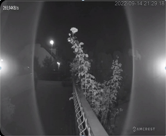

Here is a pic from an Amazon Review where someone had this issue with 3 different AD410's he returned. The originals are here: https://www.amazon.com/gp/customer-revi ... B091KMT9GB
Since SmartHome improperly stretches the image to fill the phone screen, I shrunk the sides to a normal 4:3 aspect...
Dual IR Flare.png (198.09 KiB) Viewed 1135 times
The two bright lights on each side are the internal IR LED's, NOT lights out in the yard. Crazy.
What I still can't get my head around is why the flaring doesn't just fade across the entire image sensor. How can there be such a sharp vertical cutoff to clear? Before now, I thought the curvature was due to the round rubber gasket edge, but now I see that the curve is mostly or entirely an artifact of the fisheye effect.

About the LEDS. that is going to be clearly an issue with the IR from the outside. There is 0 way that it would be able to look like that being bounced back into the camera through the Kapton tape and be 100% perfect dual dots on either side.
If I had to guess this is an issue with Lens type that is used. They are curved and even looking at my footage when I had my doorbell mounted on the front of the house you can tell it was bending. The picture isn't like it would be with a normal flat lens.

Ok so it is kind of hard to explain what I am going to try and explain.. SO here it is.. 1 the LED that is on the right side of the picture is from the left side of the camera and same for the other side. What is going on is the IR is being picked up reflected off the inside of the lens and that is why there is a Flare from top to bottom. Curve of the lens. The front most out point of the lens is the Center, then the lens is picking up left IR and put it on right of the then the curve seen is the rim of the lens.. If you look at this not so great picture of IR night you can see the curve in the lens and even at day time but this is a night issue so night picture.

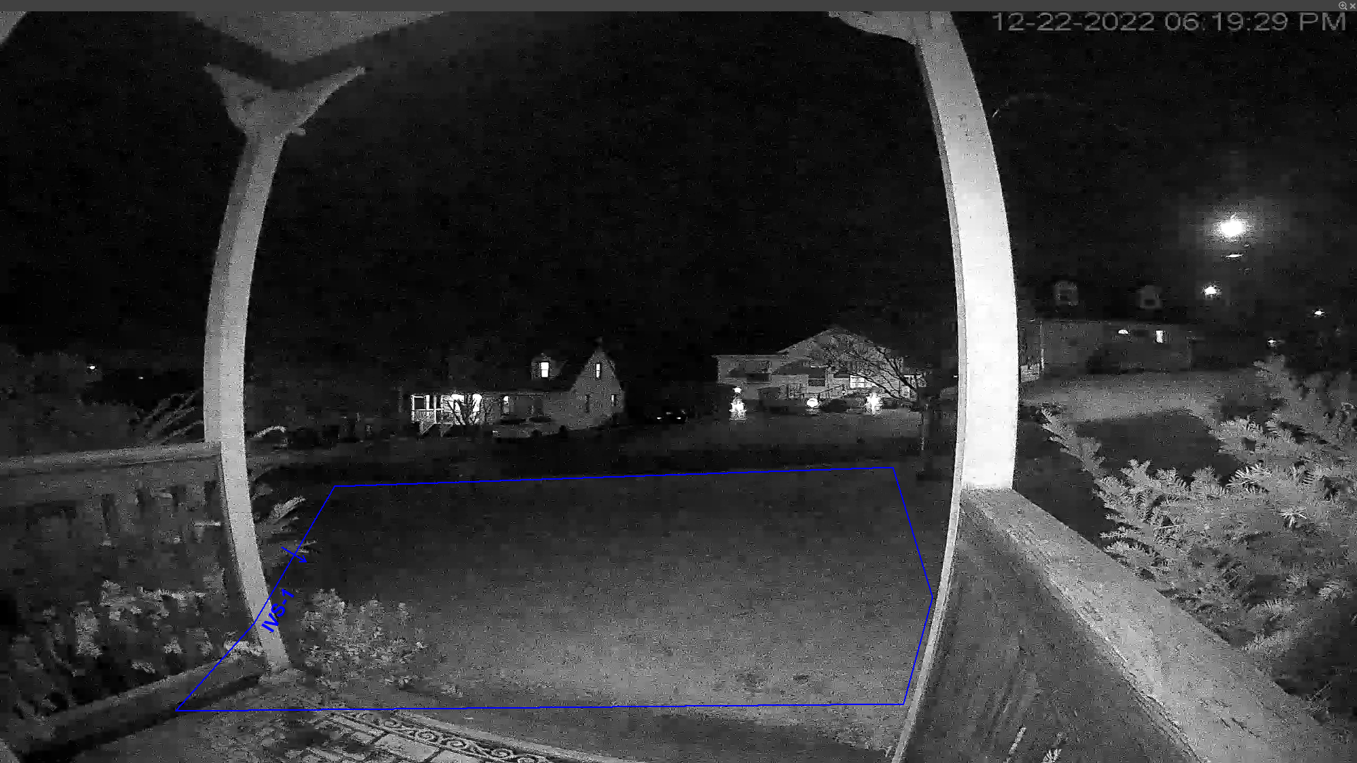

Screenshot (3782).png (1.53 MiB) Viewed 1131 times
