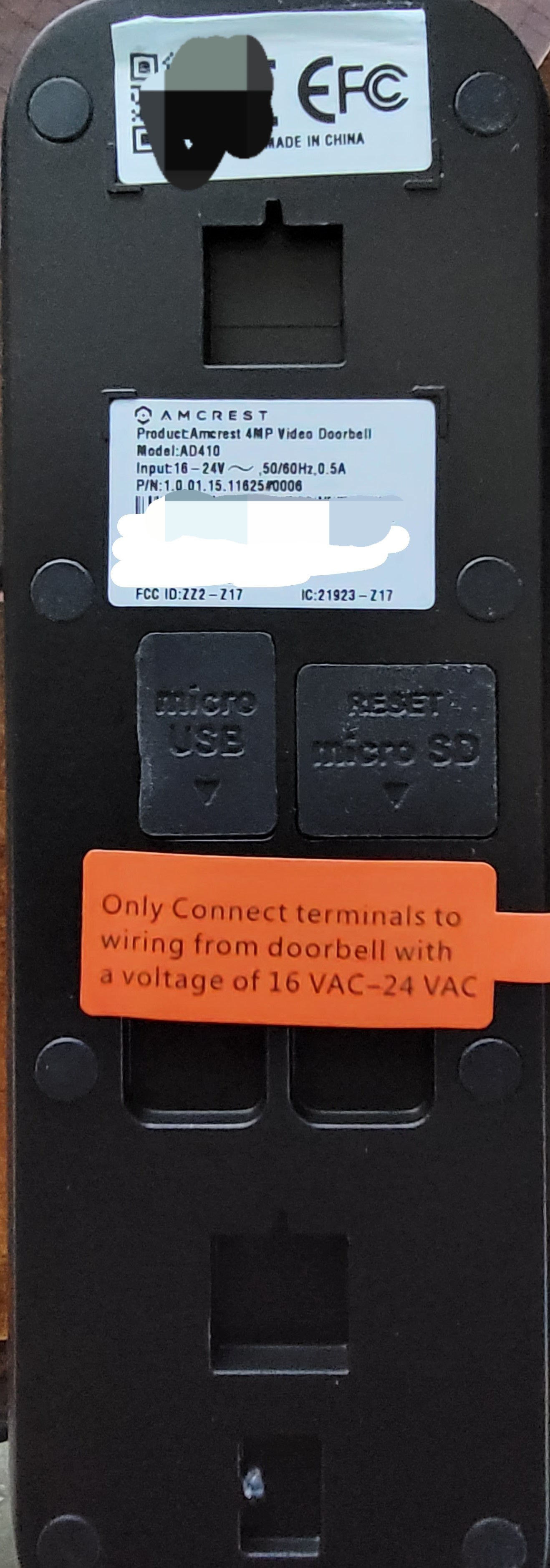

New AD410 has an orange sticker over the input terminals that says to only use 16-24 VAC. The product technical spec from the Amcrest website (attached) and plenty of forum discussion says 12-24 VDC will work fine and that polarity does not matter.

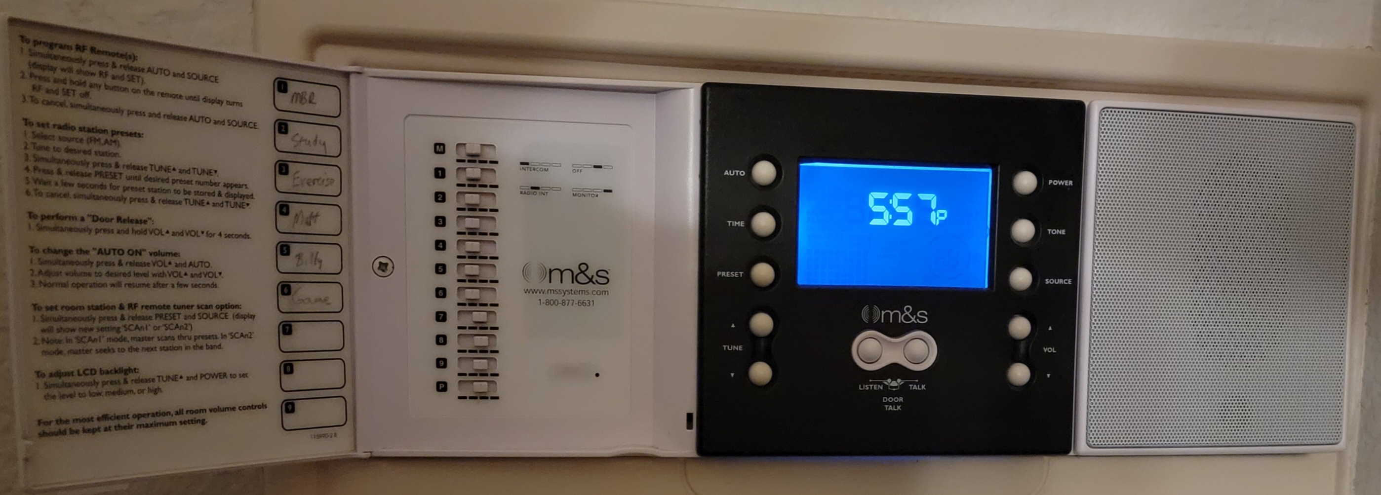

My doorbell (M&S intercom system that plays the doorbell chime over intercom speakers when the doorbell is pressed) has 24 VDC across the switch. Will this AD410 device work in place of the pushbutton switch?
If DC input voltage is OK, why does Amcrest put the orange sticker on the device?

So that is a Question asked some time ago and never got an answer. However I am wondering if that is what they want people to use under normal use (Meaning with the Traditional Doorbell Chime and Chime Kit) Most others that would use with a 12v DC power supply like myself is doing so on a Stand alone setup.
What I can tell you is that a DC Power supply will not last long if someone uses the doorbell camera like they would using AC power supply.
Not easy to explain right now. However to try and explain how it works. Normally when you connect a AC Power supply it is connected with a Chime Kit, When the doorbell camera button is pressed it in a since causes a Short Circuit. So if you had a 12 or 24dc power supply connected to the doorbell and had it setup for button press like normal going to a Chime it will short out the DC Power Supply.
I don't know your System, However in general a Intercom would have a button that wouldn't be powered, Once pressed that triggers a inside system that has power, When someone answers that system it then sends power to a Power Circuit for Mic and Speaker. So in a Since there would be no power to make the Doorbell camera work in that type of system. If there was power full time that could power the camera then it would/could short out the intercom power supply...

I have not traced the wires that connect to the doorbell pushbutton switch to see where they go, but they probably are sourced at the intercom system after a trip to the attic and back downstairs to the main intercom panel. I guess a trip into the attic is in my near future. The wires look to be about 26 AWG single strand copper, plenty adequate for the 125-200 mA needed. Once I find the source I can find out if that's likely able to source the required current.
Perhaps if someone else on the forum has experience interfacing with a M&S intercom system installation they can "chime in". I replaced the original (mid-90s) analog intercom system with a digital panel (see below) due to noisy volume controls, but it's been 15 years since I had that main panel off the wall.

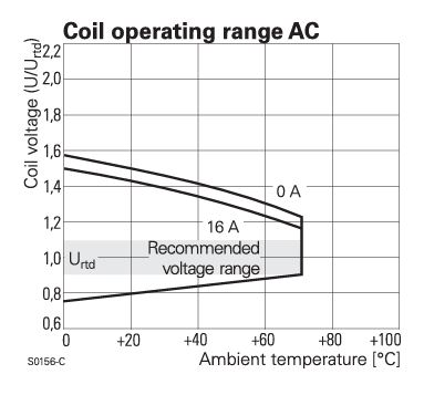

The 24 VAC relay data sheets generally show pickup voltage at 80% of rated coil voltage and dropout voltage at 30% of rated coil voltage (on at/above 19.2 V, off at/below 7.2 V), depending on the particular relay. They also recommend coil operation within 10% of rated voltage (21.6 V to 26.4V) but allow room temperature operation up to 130%-140% of rated voltage (31.2 V - 33.6 V). Chart below is from a typical data sheet
The 24 VAC relay operating at 28.5 V falls outside the recommended range but within the specified max range, especially for low current, even at higher operating temperature ranges. Long term reliability is probably better if operating within the recommended range (21.6 V to 26.4 V).
I've got an 24V DC supply as well as 24 VDC and 24 VAC relays on order and will try a DC setup, assuming that the actual voltage from the DC supply is 24 V. Do you know if the AD410 power board issues are better or worse with operation at 28.5 VAC vs 24 VDC operation?

I went with 16 VAC power (doorbell transformer mounted in the attic), Amcrest Chime Kit and 24 VAC relay both mounted indoors inside the intercom base station. All are connected as per your diagram earlier in this topic.
It's working great and is recording to Synology Surveillance Station for subscription-free storage. Also is connected to Amcrest Smart Home app.
