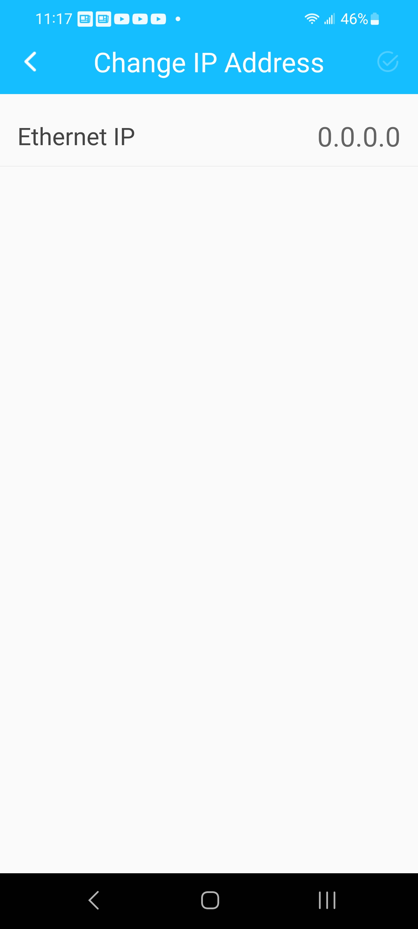

For me and all my DVR/NVR's that I have. If I connect a camera that I don't setup with a Static IP that camera can be lost in the Recorder settings if the router and camera happen to restart around about the same time. So for the Normal IP camera sure one can setup in the Network area over TCP/IP a Static IP for the IP camera. However with the AD410 and a couple of other Smart Home cameras this can also be done using the App. See picture below.. Anyway bring up the Smart Home app, and click on the Ad410, then click on the Cog top right, then Device information. In this area you should see the IP address for your camera. Click it, If you have not already setup the IP here it will show 0.0.0.0 you will want to change that to the IP address you want the AD410 to start with every time after a reboot or any time that camera loses connection.
So I have just reset my Doorbell camera and mine is showing 0.0.0.0 now because my Router has been setup for the IP that I want and I don't have any issue anymore keeping that IP and no longer need to change in the App. But if your having issues I would setup in the App along with your Router. Just keep in mind I wouldn't put in a IP that is normally in a different device.

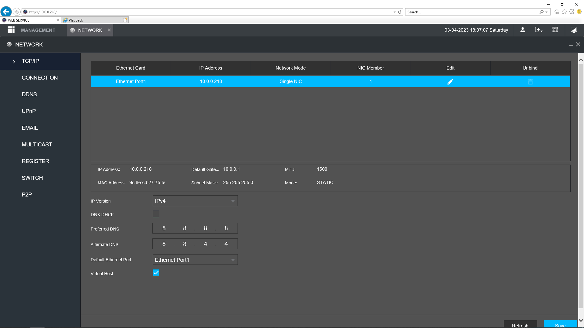

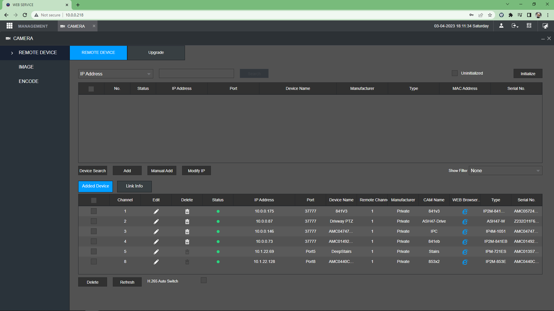

So I would look at your NVR's NETWORK area and see if you have a Virtual Host option that needs to be active See Picture below.. (About adding pictures to the Forum, You should be able to press the Full Edior & Preview button and it will bring up an area where you can add in pictures under attachments tab..)

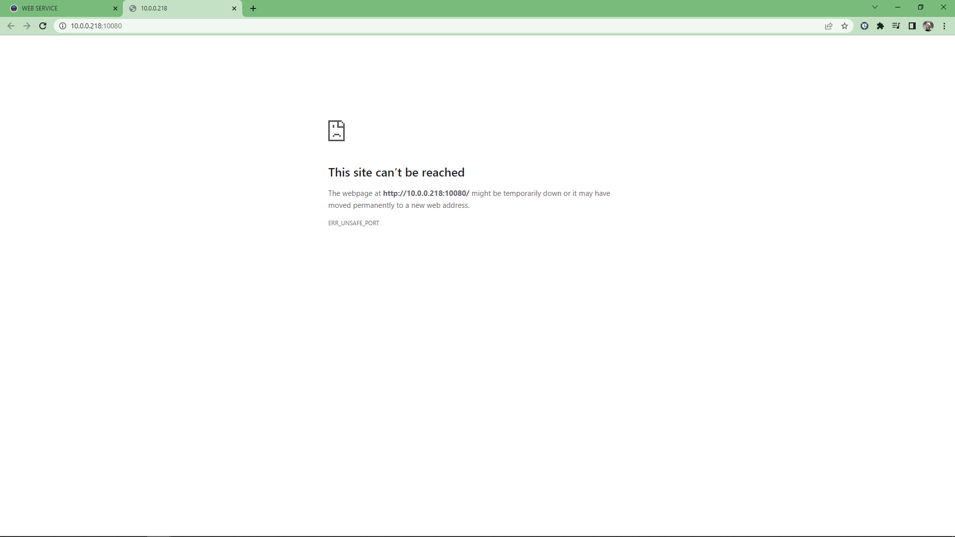

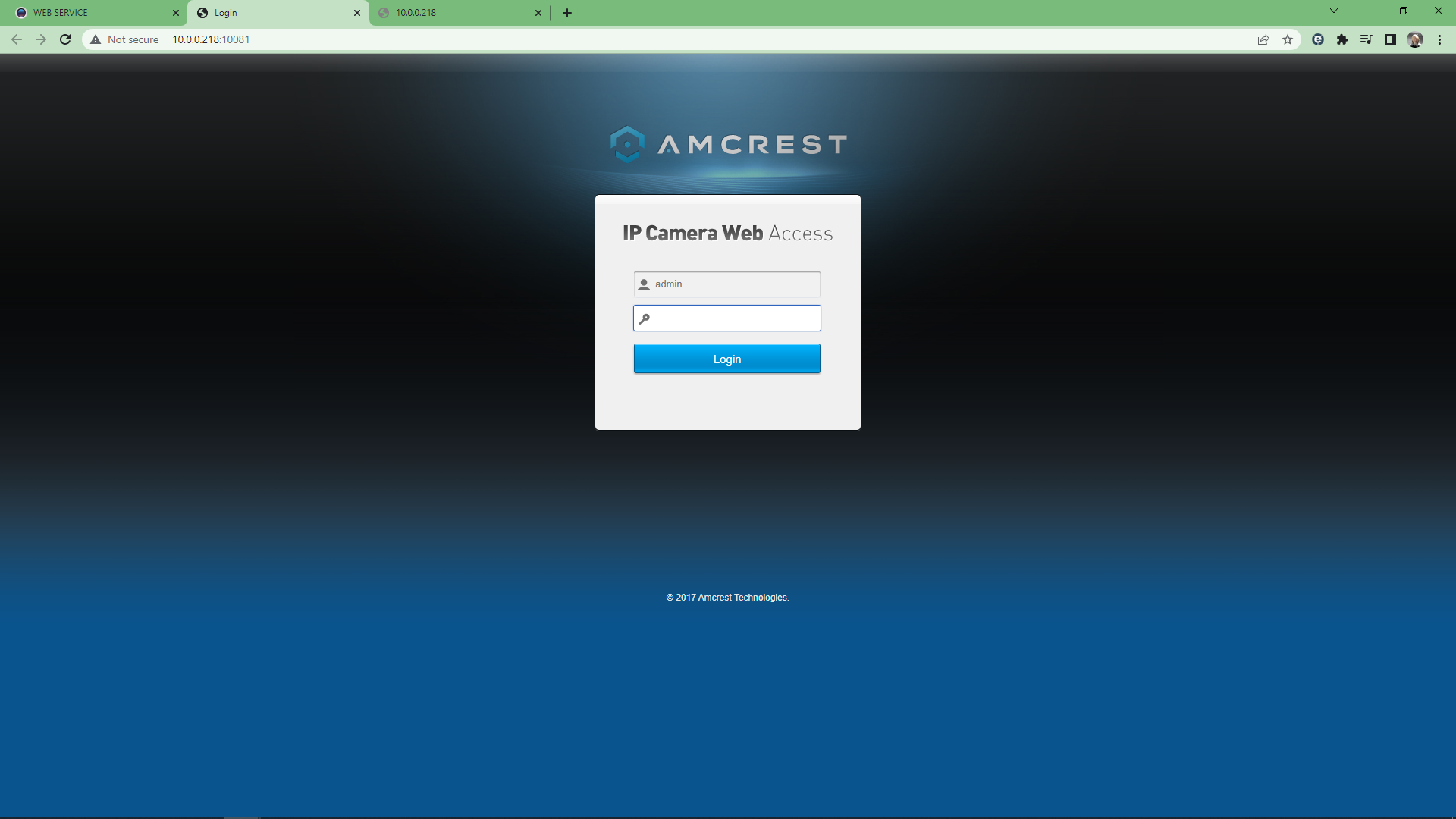

So if you turn on that Virtual Host tab, and you use Chrome or Edge, Keep this in mind. When you access your cameras you will want to click on one for the first time that you don't want to edit first this is because normally Edge and Chrome have 10080 port setup as a bad port? Anway by clicking lets say you have 8 CH POE on a 16ch NVR and you want to work with ch4 then click on ch 1-3 or 5-8 first and then go back and click on the ch4 it will open in 10081 and will open the camera WebUI under the NVR's IP..
However I use IE most times, For me it is still working and for others it no longer does. Even if you use IE tab in Edge or Chrome you will need to still do the camera you don't want access to edit and then click the other. IE is best option with no need to click one first. So in IE i can just click and use the first 10080..
