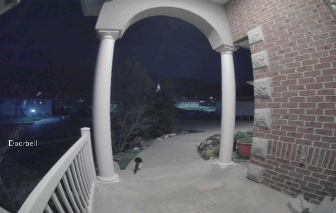

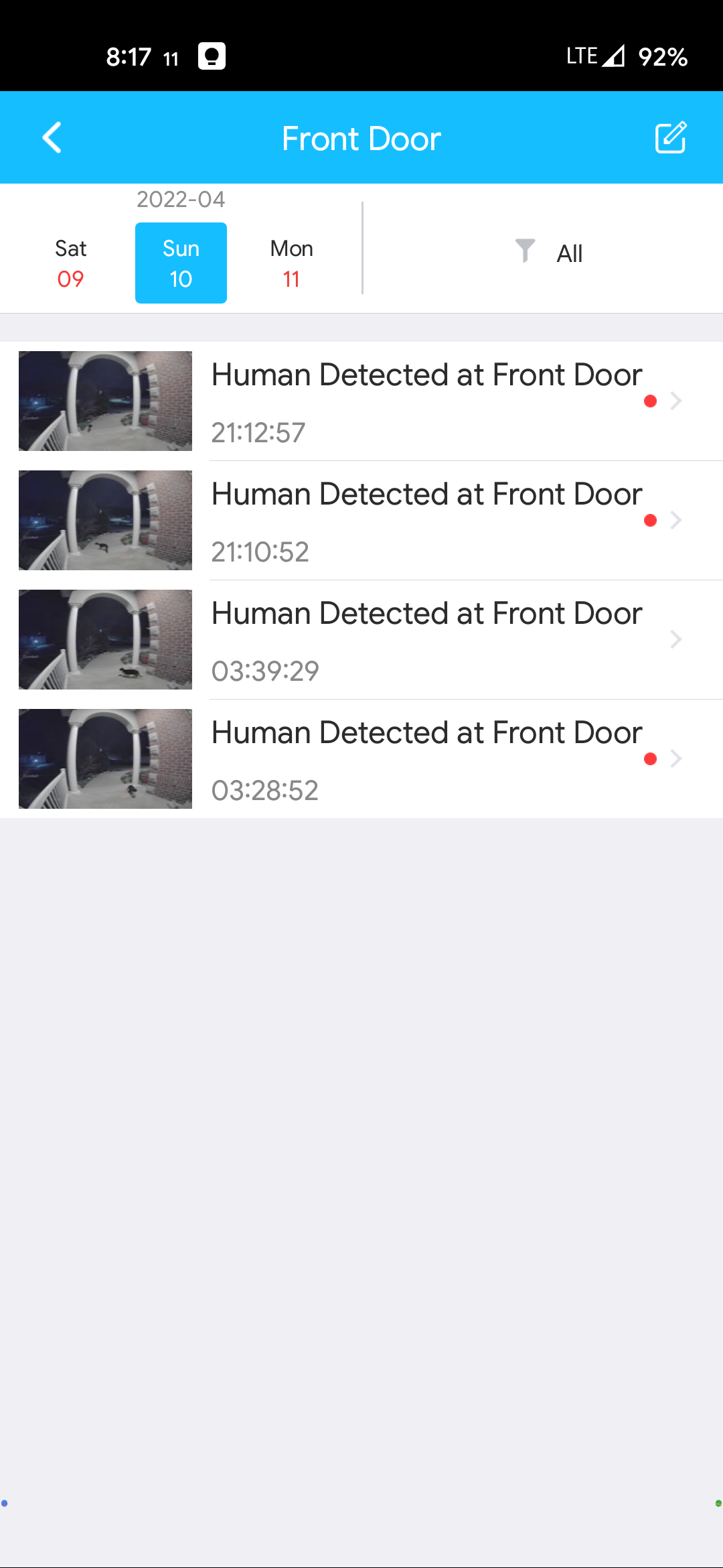

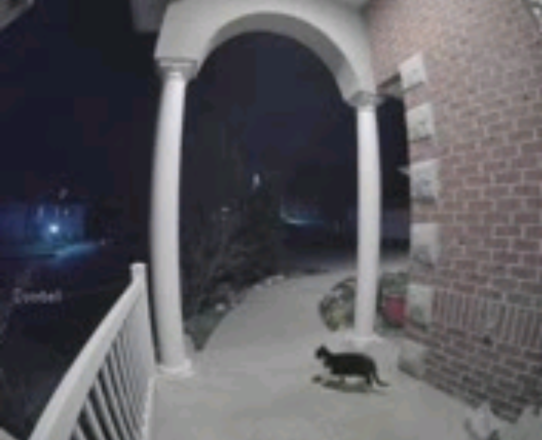

My new Ad410 doorbell is detecting a cat as Human Motion (see attachments):
I have adjusted the detection zone for Human Detection and have also decreased the Human Detection Sensitivity to Low.
The only reason I bought this doorbell is because it was advertised as having Human Detection, but it is not working correctly. I need to be able to detect only Humans, not animals. Any suggestions (besides scheduling Human Detection off at night)?
AD410 Detecting Cat as Human Motion

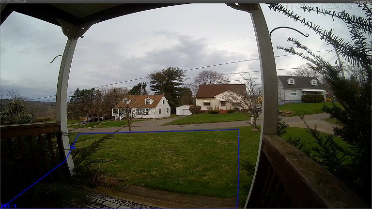

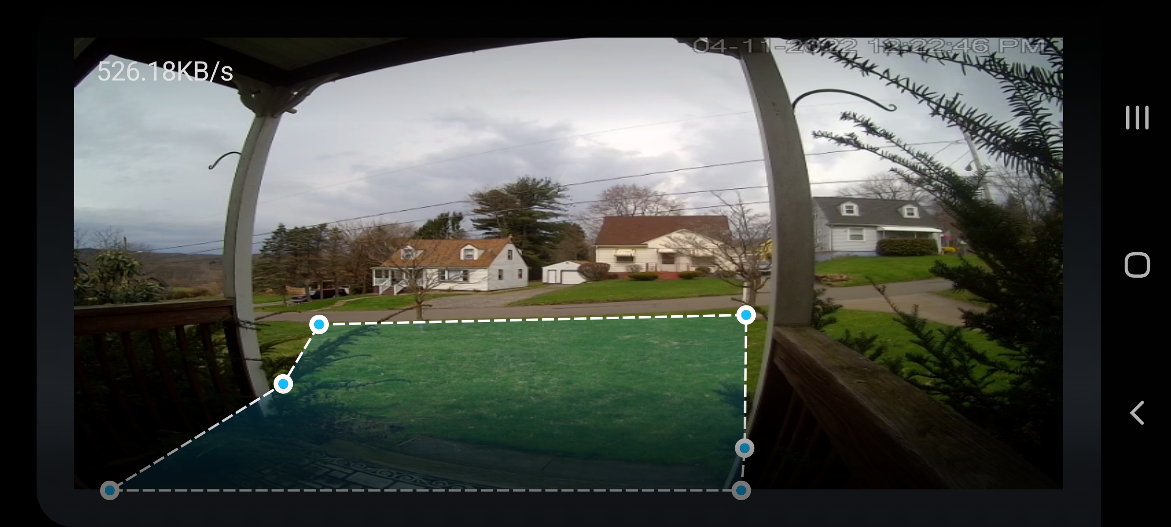

So I am clear normal motion grid and human grid are setup different and would look like pictures below. First one is from Smart Home app and is the Grid for my Camera. Second picture is from my 4216E-AI NVR that translates that into an IVS rule like it was coming from a AI camera and you can see that in the picture they are the same.

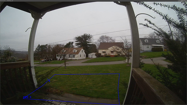

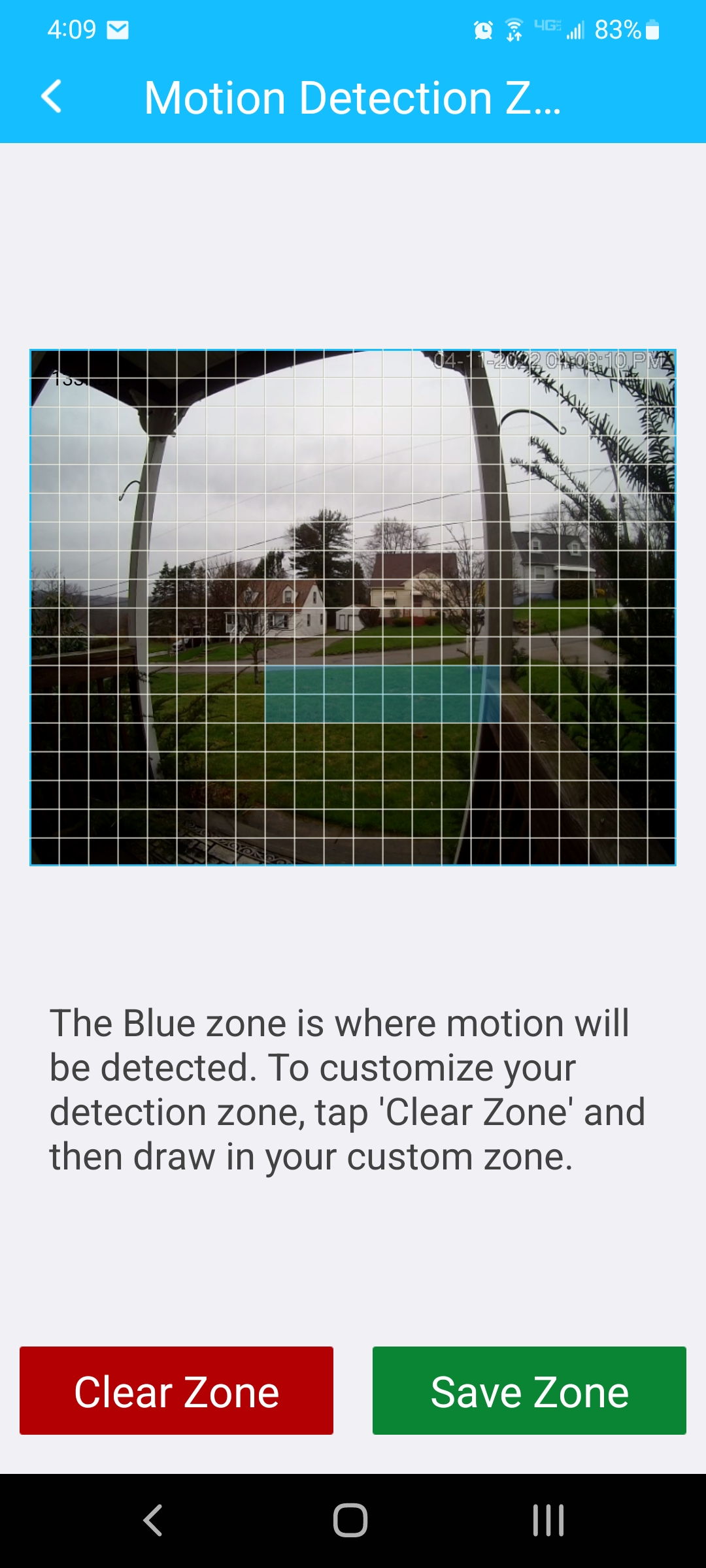

So here is something I would do. Only an Idea. I don't have motion on mine turned on. That mainly has to do with all the traffic I have on my road 400 to 600 cars a day go by my home. Every time a truck or high enough car turns the corner to go down the hill in front of my home it will trigger a motion event. So i just turn on Full time Recording on my AI NVR for Audio mainly Then IVS picks up any humans.
Anyway for your setup. I would look at maybe doing a human grid in your Drive and limit the Motion to the front porch. Then when human is detected it should give you lets say a Pre Alert before they even get to the door. Then Motion on your NAS if they go to door. Also I guess what I am trying to do is change the area of the Grid for Motion to different area for Human Seeing you have them both turned on having motion by the door will still pick up the human after they have gone though your Human Grid in your Drive and walk to the front?
Here are a couple more pictures one showing Motion grid and one showing from my AI NVR the Human detection grid shorter then my first to try and give an idea of what I mean from 2 different parts of your area of View..

Hmmm. It looks like Cat Woman (a.k.a. human).
