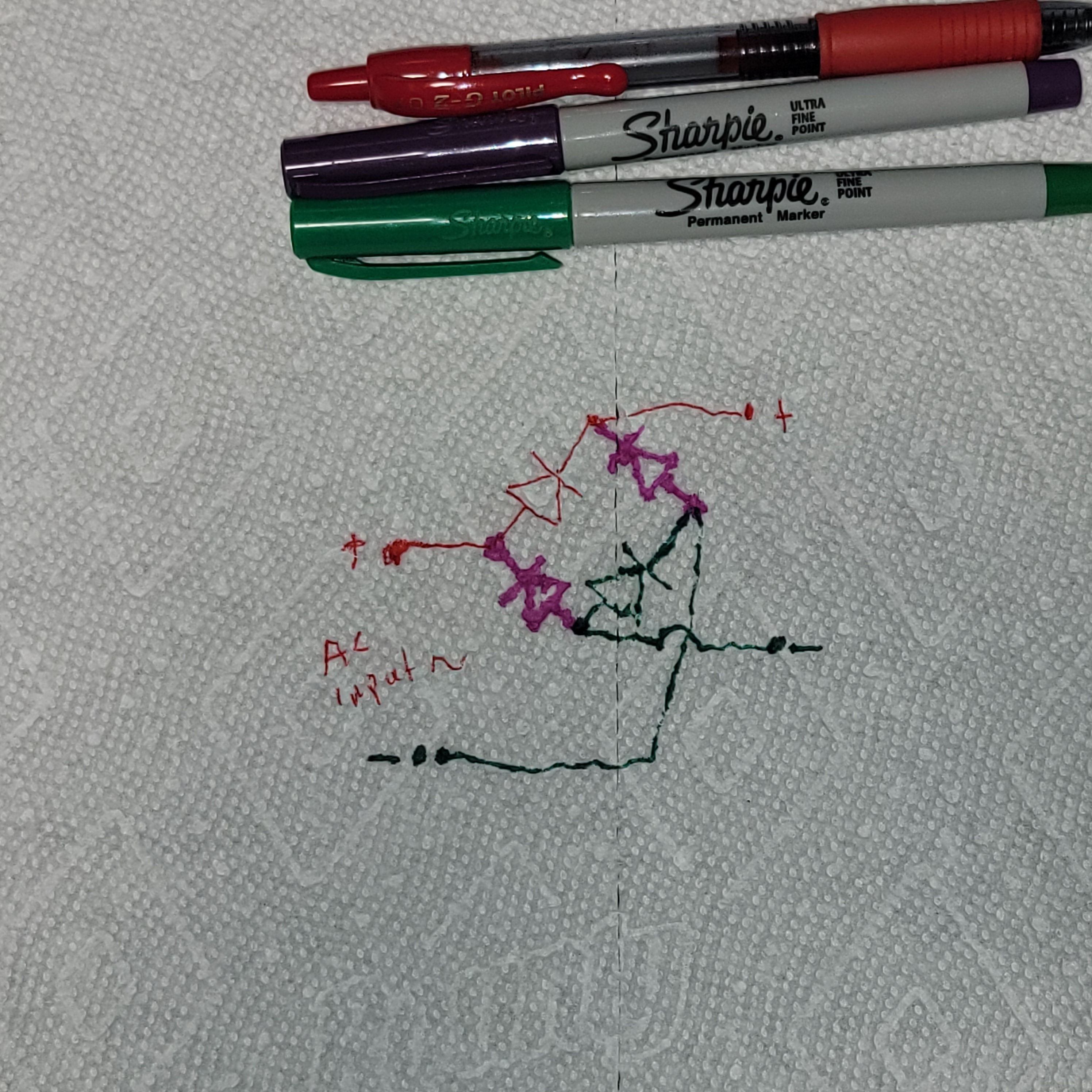

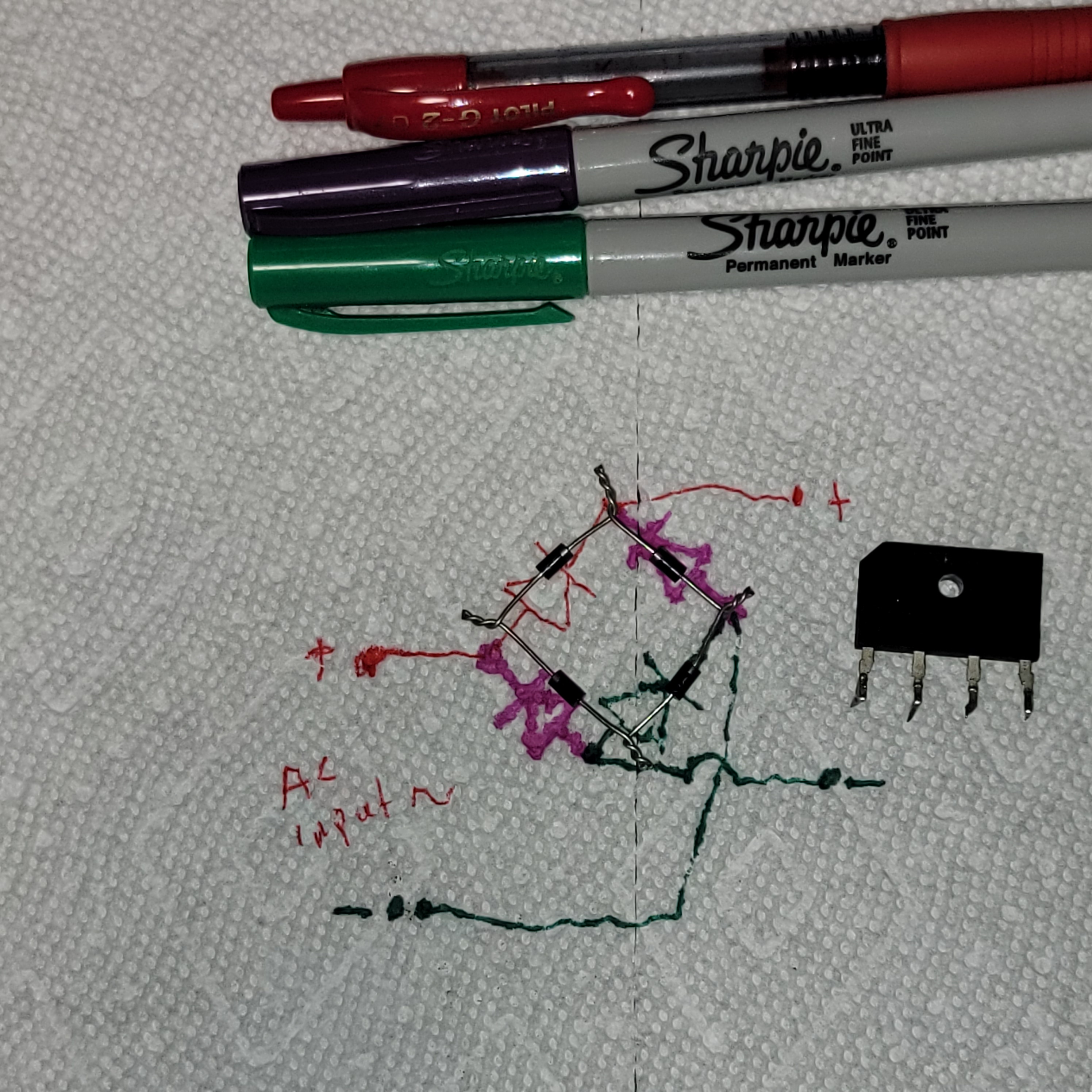

The Camera is normally a AC. This means that the camera is going to have a Bridge Rectifier and because of this the camera don't need to worry about Polarity marked. What happens is the Bridge knows what needs to be + and - and will only give such to the cameras internal circuit.
I have not looked at any of my older cameras for long time but if I had to guess they might have only used a Single Diode to change the internal voltage to the DC that the camera would need. Today using a Full Bridge that makes it so no need for marked Polarity. I did just to confirm change out the Polarity on my AD410 and it is still working as it was before the change. I have my AD410 working without a Indoor Chime and powered with a 12v DC power supply
However doing this normally the Voltage Drop would be little over 1v however I have not tested this but normally because of the Full Bridge Rectifier there will be a voltage drop
Crude fast drawing of a Bridge Rectifier

Also to show what they look like in hardware I made a fast one 4 diodes and a real one the the right if you zoom in to picture you can see the + and - of the real one pulled from a device
