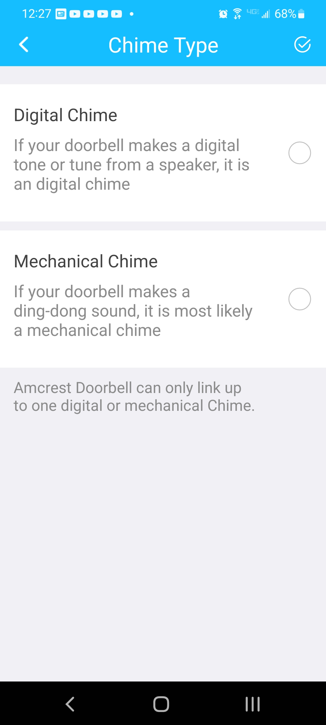

Don't know what Version your using. On my Samsung S21 Ultra it is under setup and Doorbell Quick Response? Then there are the 3 that it comes with and a + at the top to make my own? I don't have to go 10 deep to get to it?
About the Crash? That sounds like Over Voltage (Or) Maybe Chime was setup? IF you click on Chime and the first option, is there any checks in the area of chime Digital might show how long it is setup for? IN my picture below no checks and for my 410 I don't use a indoor chime and I have mine connected to a 12vdc power supply..
Yes I did read that you said you skipped? I just asking to make sure? Maybe a Reset will be needed to Cure the issue?

Confirmed Nothing checked in chimes
