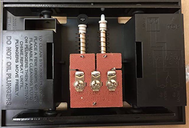

It's a NuTone Two-Note Door Chime probably original to the home of 1986 and uses a 16v 10w chime transformer (according to the user manual, but we've thus far been unable to find it in the house!)
It looks like this:

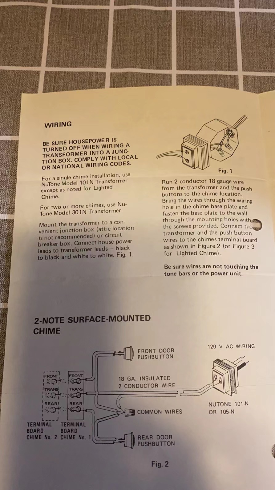

And the wiring is like this:
And the Chime Kit is wired to Trans and Front.

Maybe to double check while your waiting for your new Transformer to come in if you ordered online, I would take doorbell camera off wall, Remove Chime Kit, Make the connection of the 2 wires where the doorbell camera was connected (That would be like your old doorbell button being pressed) and see if your Chime rings. If it don't then the wires that were soldered onto the tabs of the doorbell might be damaged behind the red cover.
Taking the 2 wires again this is without Chime Kit being installed at T and F and the camera disconnected. Shorting the 2 wires that you connect to camera would complete the circuit to ring the Chime. If no ring of your Chime it is damaged.
