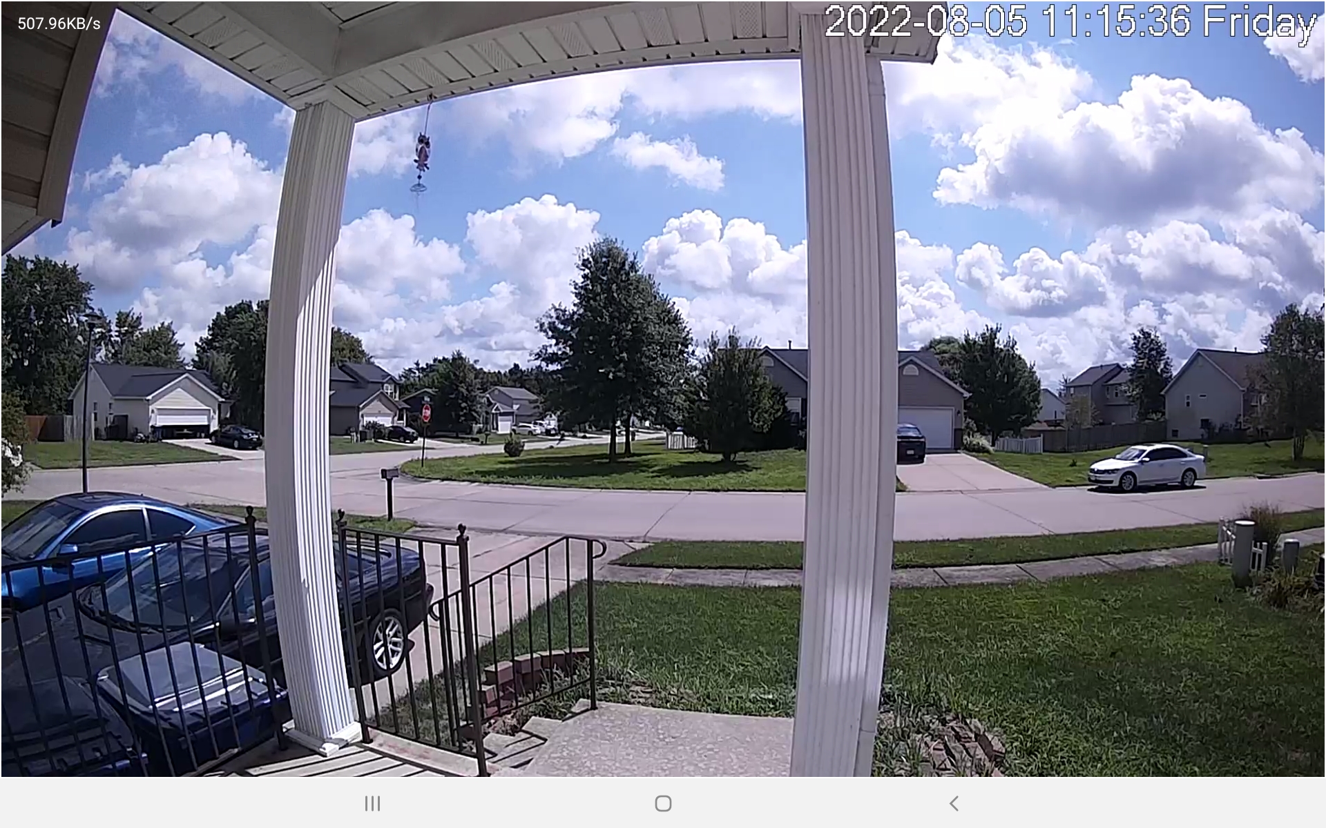

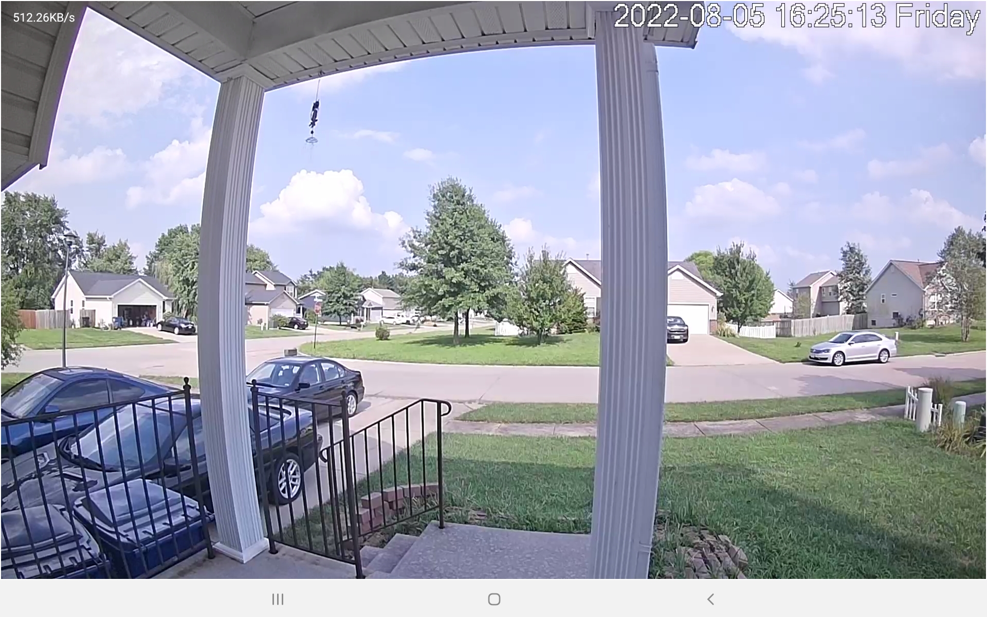

I saw there was an update for my AD110 doorbell and I updated it. Now the video looks all high contrast and washed out.

I agree, Same with mine.. To be honest it almost looks like the WDR while it might be active again or added back it looks like it is always on like it or not. I say this because when I turn on WDR in App there is no change to the Picture like other cameras that I own with True WDR..
Why do I say this. Well I have another AD110 that I also updated. I have it in an area that is new location. I had some issues so I took another AD110 that I own from it's location I didn't update to the newer FW and I reset them both back to Factory. I setup again. I didn't make any changes to the settings after the adding back in to app. I have not logged into any 3rd party software and I can clearly see that Picture of the updated one in the location it is in has higher amount of detail then the one that wasn't updated to the newer FW. Also with the camera I have then made some changes to the settings in WDR and all changes made, don't make any changes in the quality of the picture.
I also Reboot the Camera to make sure that it wasn't a cache issue also made the mistake of clearing the app cache don't want to do that again lol
