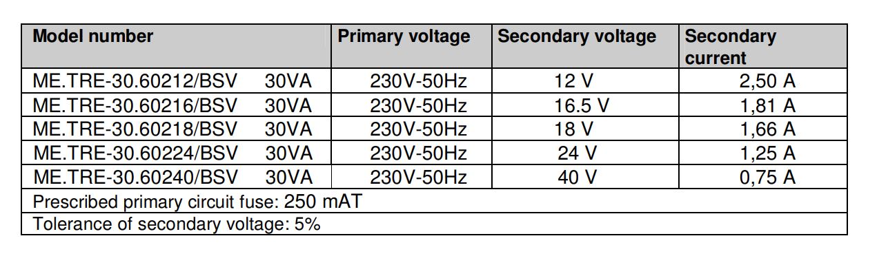

Hi, Might have an issue with the Vemer VN31900010 Transformer TMC 30/24 DIN Bar for Continuous Service 230V/12-24V Power 30VA, - I have the data sheet and it has a rating of 16.5V, My Chime is max 16V ? This would cause an issue .....over load to the Chime.
Any thoughts ?
Vemer VN31900010 Transformer TMC 3024 DIN Bar for Continuous Service 230V1224V Power 30VA, Data Sheet.JPG
Vemer VN31900010 Transformer TMC 3024 DIN Bar for Continuous Service 230V1224V Power 30VA, Data Sheet.JPG (100.09 KiB) Viewed 5105 times
Re: AD110 UK Install Mobile APP Issues Crashing using QR + S/N
Personally I don't think the 16.5 will matter much. I have both 16.5 and 16v and when powered with no load they both are within 120mv of each other.. Meaning normally there is a + or - x% for things. I don't think the 16.5 seeing the data voltage is only 1/2 volt higher.
At load only thing I will say is that the 16vac transformer take a dive much faster then the 16.5vac transformer does. But that might also be because the one is 40va and the other is only 30va..
However in short when doing a test using both Transformers on a device that was looking for 16vac supply. Both of them were over 17vac and the normal 16 at first was little higher. However when they both were running for 1 hour of use the 16vac transformer did drop to 17.122 and even after testing the other one and then putting the 30va back on for some numbers it never reached the first set of Volt from the first test..
Also there are others that I have seen make videos testing 16vac transformers that were running 10va and they would produce over 20v so I am sure if you looked at your doorbell system at least the ones I have on the package it normally will have a 14-22vac range or something.. Not that you want to run it at 22vac and I have seen some that say 13-24 and again you don't want to run at 24v constant if any of that makes sense..
Is your Chime Mech or Digital?
Edit: also looking at your Picture says 5% so that would bring up to around 17.32vac and again I am sure is going to be in the range of your doorbell system

Revo2Maxx wrote: ↑Mon Sep 27, 2021 1:05 pm Personally I don't think the 16.5 will matter much. I have both 16.5 and 16v and when powered with no load they both are within 120mv of each other.. Meaning normally there is a + or - x% for things. I don't think the 16.5 seeing the data voltage is only 1/2 volt higher.
Would the Mechanical Chime not cause an issue receiving an additional 0.5V As its max is 8-16V Honeywell Home Ding Dong Classic Wired Doorbell – White, D117. Night over heat or even buzz. - ?
