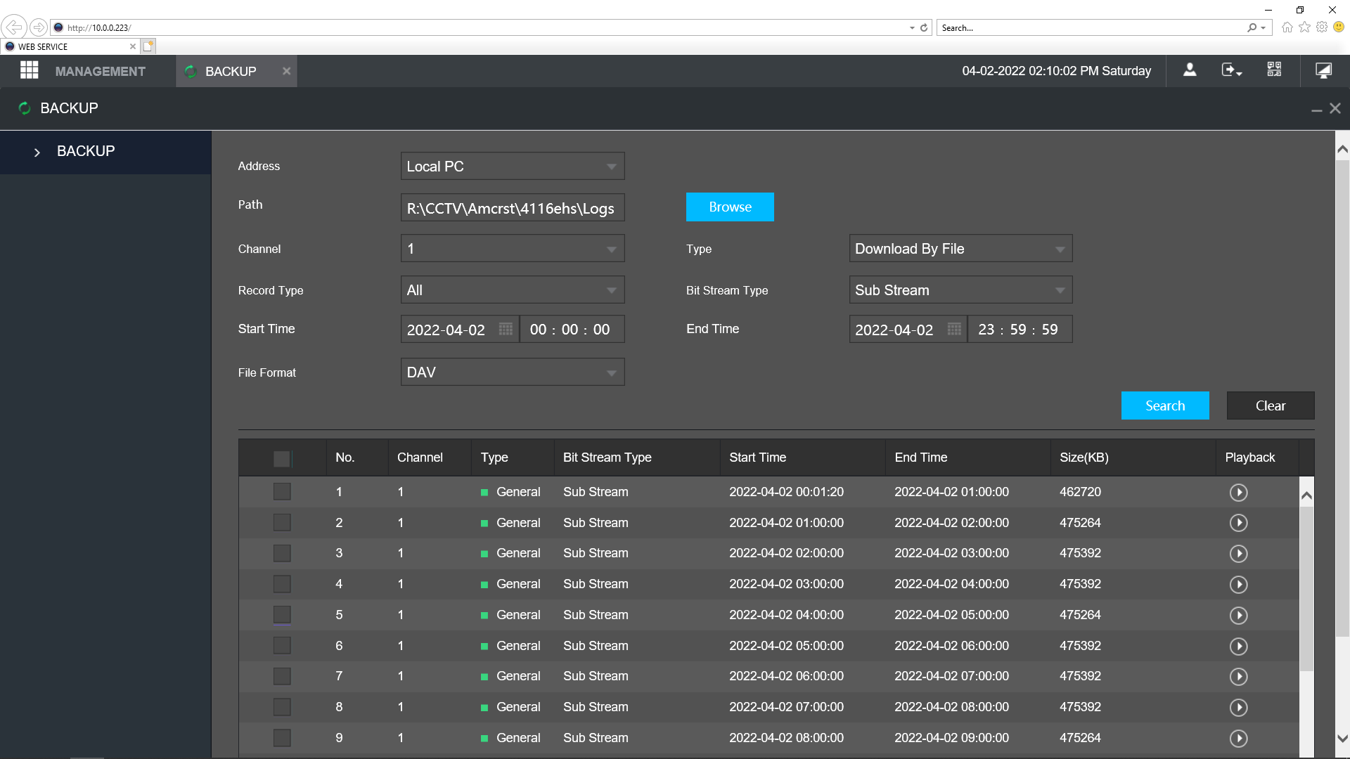

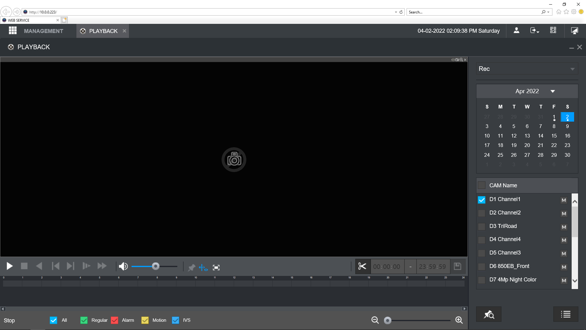

Here is something to think about. If you want full time record on Sub Stream I would set your NVR Substream for the camera to Manual. Then when you go to look at GUI or even WebUI for your camera Stream records there will only be what you asked for in my Case AI Human only see picture below there will be non listed in Ch1 and left them all in search so you can see no trickery going on. Then doing a Backup search, Using main stream I get no events (Same as Playback so I didn't show in search in back up) however then change to Sub Stream and you can now see all full time recording for the doorbell. It will be on lower Stream size recording but Video and Audio will be there and might be important event missed can be found there for backup...
This was from my 4216E-AI WebUI under backup. This is the same for the 41xx-HS as Don't pay no attention to the path that was just the last path I saved things to seeing it was where I was pointed at the time for backups..
Screenshot (2244).png (99.15 KiB) Viewed 4249 times
Screenshot (2245).png (127.96 KiB) Viewed 4249 times
