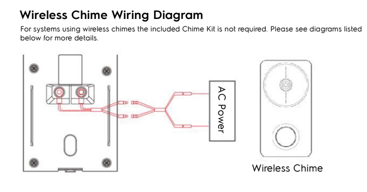

Thanks for the reply. That's disappointing. The WI-FI Video Doorbell User Manual on page 7 (Wireless Chime Wiring Diagram) does not show ad110 hardwired to the chime.

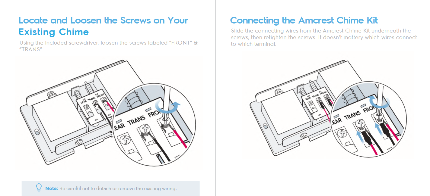

page 5 of the manual shows how the chime kit is hardwired to the indoor chime.

the diagram is right to show the included chime kit is not needed if you're setting it up with a wireless chime but the diagram was incomplete when it's missing a transmitter to a the wireless indoor chime.
i think you should look into the ohmkat wireless universal video doorbell chime since there is a transmitter module that you hook up to the video doorbell so it can send a signal to the wireless chime when the doorbell button is pressed.
