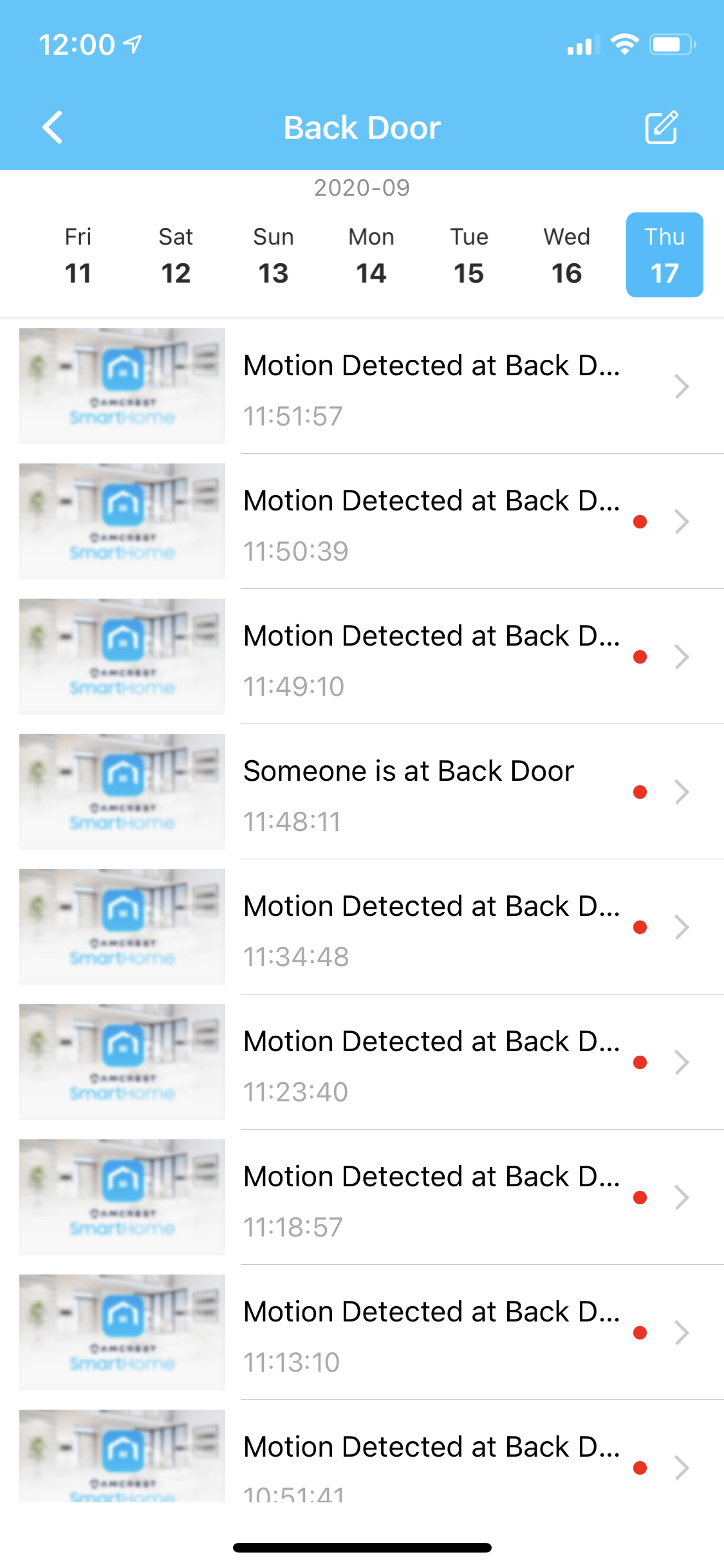

Hello, anyone has the problem with the doorbell not showing any liveview event snapshot? I try to restart and hard reset and nothing will fix it.

hi @nismo4gtr and welcome to the forum. i just noticed my motion detected snapshot is not working as well. i'm on firmware 200828 which also has the motion detection zone view issue. please raise a support ticket if you have not done so.

Well, I've NOT updated the firmware and have the same issue. I hadn't noticed this - thanks for pointing it out.
I checked my SH app version - still 3.50 and Google Play still shows June 1, 2020 when it was last updated on the store, so problem not related to an app change. So if not an app change and not a firmware change, it was a backend server change that broke this functionality? That seems so unlikely, but WTH else could have done it?

I am getting the same error also. Thought it was just me. I have updated the firmware.

This works for me but only when I don't use a SD Card... which is mind boggling.

still having this problem, latest firmware.
