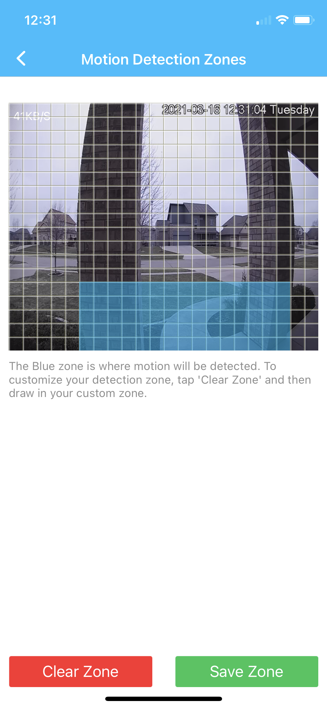

It seems to pick up cars in the street pretty good, but as far as picking up people it does a very poor job. In the 1-2 months it has been setup I don't think it has recorded a single package delivery. People would walk up out of sight until about 10 feet from the door when the walkway comes around the garage. I would think in those 10ft of walking up to and away from the house it should trigger but it doesn't seem to happen.
I have my range currently at 5 (it has triggered by the neighbor shoveling his snow or sometimes turning on his lights at night) I also have the target area covering the whole page instead of selective just to see if I can get it to record these things, but still no luck.
It gets triggered multiple times a day by cars driving by. Although for some reason it doesn't seem to always detect my vehicle either..
Not sure what else to do at this point, but it is getting pretty frustrating that it doesn't record the main thing I want it to.

Post by tmodlin »

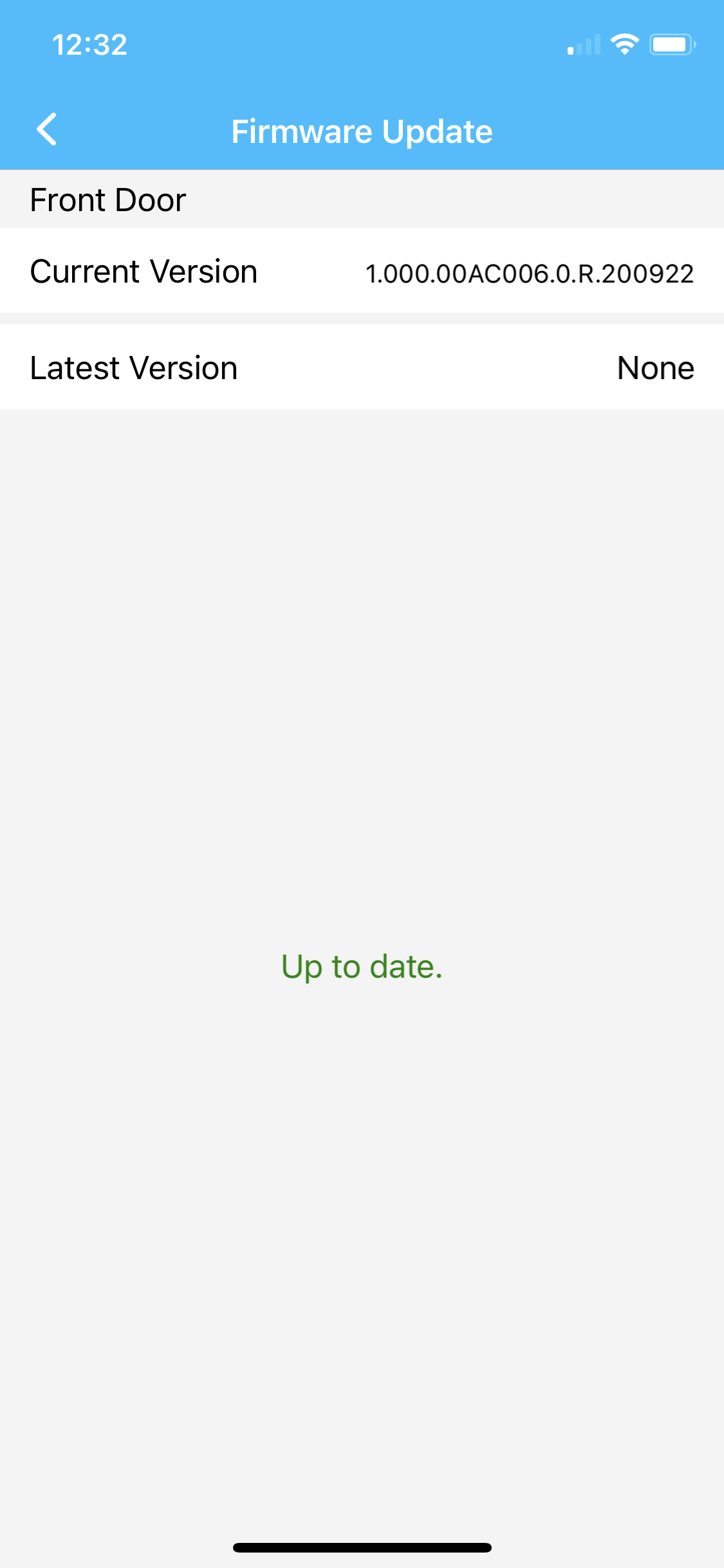

Are your updates current?
I just ditched my Ring because of the issues I was having with notifications and my Amcrest has been working flawlessly.
My range is 4 and see attached for my zone. I don’t get any triggers from the street or sidewalk which I constantly did with the Ring.
Firmware screen shot also included.
