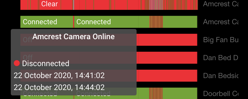

So did the update on the 22nd, the drop at 14:41 is the update, as I like many have had ‘power’ issues and just a few too many notifications, at first I still had the old grid system, left night vision on auto, notifications were reduced but come dusk it had the usual reboot loop for 45mins, then fine, hasn’t missed a beat or dropped since. And it now shows the 3 zone motion set up. Weird but that’s 2 nights and it’s not dropped yet.
Re: AD110 firmware v1.000.00AC006.0.R.200828
Thanks @Danual for sharing your experience with the latest update. Fixing the night/IR reboot issue was expected, so it's good to hear you confirmed it.
For anyone who is curious about the graph Dan posted - that is from Home Assistant's event history log. All those thin vertical lines show a change in state. The top red bar I believe is showing motion detection events, which probably far too many. The second "Connected" bar is showing the AD110 online status (green) and the red lines are when it has gone offline.
