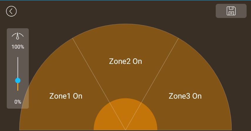

My personal opinion is that if the PIR works and I am not constantly getting MD alerts from shadows, leaves blowing and cars passing by on the streets, they can leave the semi-circle as is and not go back to the grid overlay.

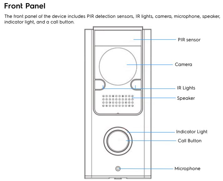

The PIR is shown at the top of the doorbell. You could try taping over it to see how the MD behavior changes.

If indeed the “fix” for excessive motion triggers was to remove video-based motion detection in favor of only passive infra-red detection, then the return to a more coarse three zone configuration would be correct. PIR cannot precisely “see” areas defined in the small grid-based zones. The grid is for video-based motion detection.
Interestingly, I found that the firmware just previous to this latest release has been very reliable for motion detection - few if any false triggers and a grid-based configuration. I plan to ignore the new update until more info is available.

First Thanks Gary for the Photo and I thought maybe seeing it was not working right first time around that it was something that wasn't active.. However I see it is on still the Old FW and the new FW so the whole 3 grid half moon thing has me wondering lol..

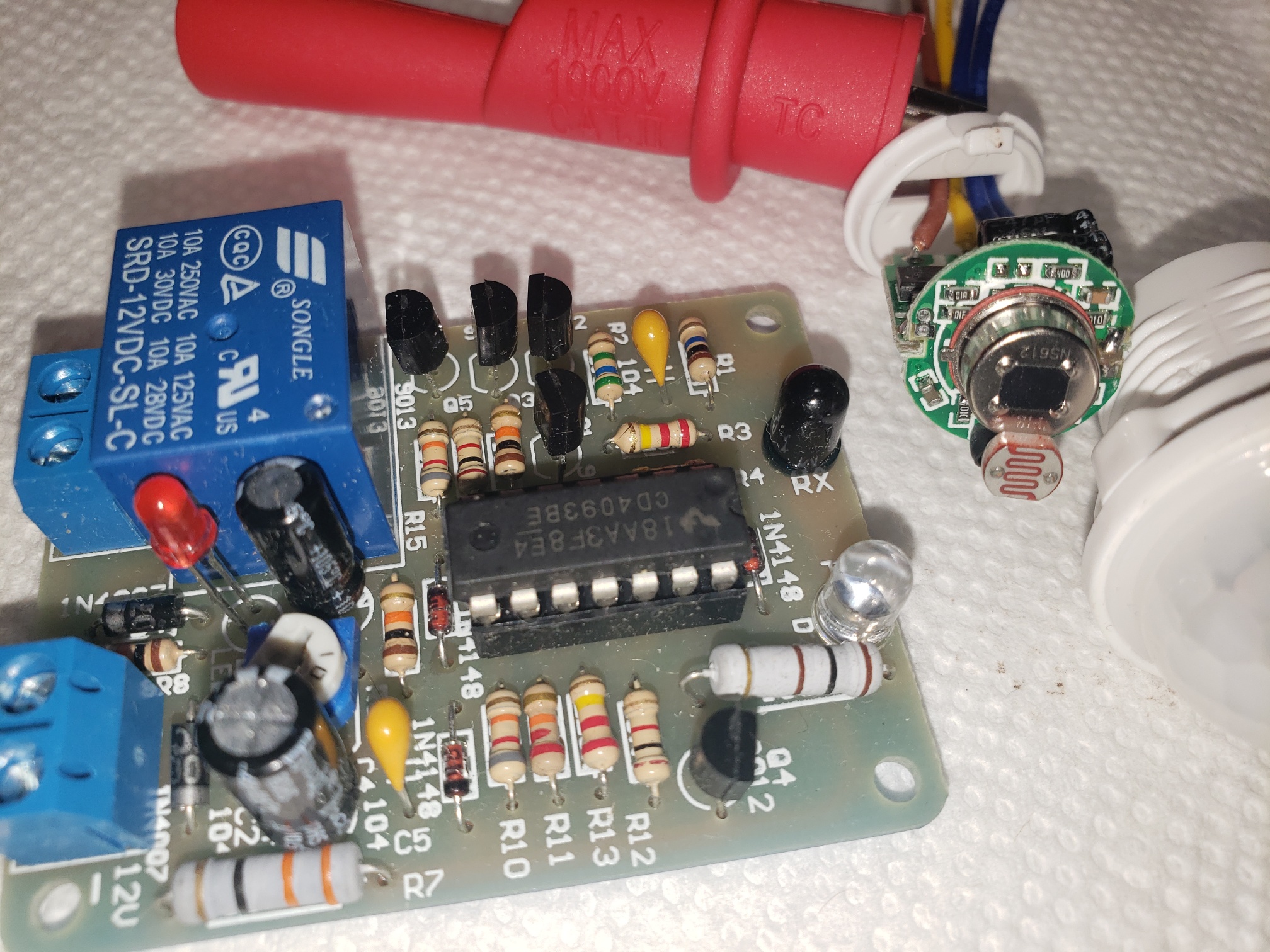

Then the PIR is a IR Sensor and in my mind not the Normal PIR that would be used for True Motion Detection in alarms systems... I did upload a picture in the last one and I will in this one as well to show the difference between the 2..

ON the left a Active IR Sensor has 2 LED one for IR and the second as a Receiver for the Reflection kind of how a Touch less facet works and the one on the right next to the white housing is a PIR that is in alarm sensors and motion lights

i can live with the passive pir 3 zone view if it works better than the video based grid view to prevent false alerts but i can't currently see my outside to validate if the zones are properly set. is everyone seeing the same view like me?
