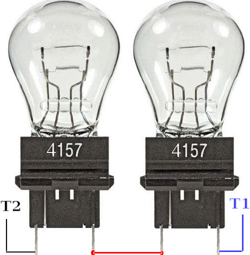

For the ones that don't know how to run 2 12v bulbs in series I would use a 3157 or a 4157 type bulb unless you have sockets for 1157 bulbs or want to Solder them... Anyway on the 4157 or 3157 bulbs take the 2 outside pins and pull them up from the bulb.. Lay out 2 bulbs side by side and now you have 4 total pins.. (We will call them 1 2 3 4) Take the 2 inside pins and connect them together 2 and 3. Then take the 2 outside pins and connect one to each side of the power supply and in effect that will give you 24v and 2.5amps... Should be constant voltage at max current and if the 16.5vac is like mine and will work between 19.2 to 19.3vac the load would run in constant current.. If there is bulb damage then the system is out of wack and supply would need more testing for current and max voltage... Also using the Blinker side aka brake side of the bulb will run hot and if you think about blinkers and brakes they don't run a long time that is because they would be really hot so keep in mind as the bulbs will get hot if they stay hot to long they will blow
Re: AD110 Doorbell Persistent Night Vision Off
To help the understanding of what I am talking about with adding 2 bulbs to make a Series connection... This was a Very Rude and Fast Making of this picture... As I said lay them out the 2 end pins are for the High Current set the inner ones are for 500ma set aka Running lights... Connect the 2 center ones and the 2 out side pins are what you would connect to Terminal 1 and 2 of the Transformer for testing... Also this is of 2 12v bulbs and they can work at higher voltage then 12 normally so around 13.8 would be at max normally However if you test your power supply and it is doing over 27.4vac then you will need to either add Resistors or you can add another bulb to get up to 36 Volt range...
