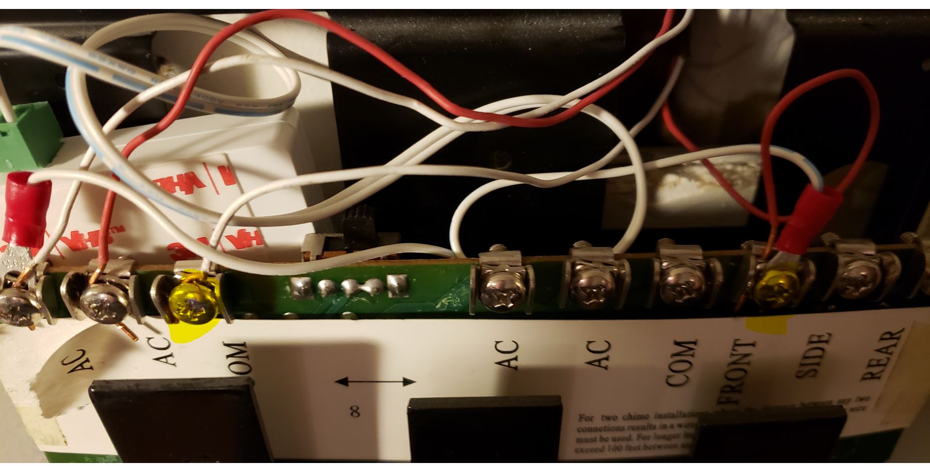

Tried installing my new AD110 doorbell cam. My doorbell chime is a bit different, as it has 4 wires coming out of it. I can't get to my transformer (finished basement), but I'm pretty sure two of the wires (Left 2 AC) come from it. I've highlighted the wires that I know go to the doorbell. So, I've connected one of the wires on the chime kit to FRONT and then to one of the AC (Far Left) which I'm assuming would be equivalent to TRANS on most chimes. The unit just reboots constantly. I'm able to view the cam feed for as long as maybe 30 seconds or so and it reboots. This goes on indefinitely. Any suggestions would be appreciated.

From what it sounds like let me make sure I have this right.
Transformer in basement comes to this panel your picture is of. Then your Front doorbell is marked in Yellow. Can I ask a dumb question to why your Chime kit isn't connected on the Yellow then?
Also what is the Voltage of your Transformer in the Basement?
Right now this is what I would do faced with this. Grab a Multi Meter, Remove Chime Kit, Remove doorbell (From now on known as camera, (Chime AKA noise maker will be known as Chime here on)) Next part needs 2 people or being creative. Need someone to hold multi meter on Front term and the other yellow term with the meter in AC Voltage, Then Someone needs to connect the 2 wires that was connected to the back of the camera together. (This will in a sense act like you pushed a normal doorbell button) at that time voltage needs to be read. Should be 16vac
Now at that same time there will be the sound of the Doorbell so the person with multi meter task might need ear plugs or head gear. If there is no voltage at that time then 2 yellow dots are not the connection your trying to work with. Once you know what 2 terminals make the chime ring when you put the 2 wires from camera together those are 2 you will want to connect your Chime Kit too (For this writing I am going to say it is the Yellow) so one wire of chime kit on Yellow, other on the other yellow and connect the Camera back to the doorbell wires and give it a minute or 2 to power up. Once you hear it say that it has connected to the Network (If it has been already connected once before) then you can move on

Hi, thanks for the response.
If I connect the chime kit to yellow, the door bell rings constantly. I tried that first, and realized I was closing the circuit causing it ring non stop. The way I have it now should be the equivalent to connecting one to FRONT and one to TRANS which is what the instructions describe. I'm not an electrician, but it became obviously real quick that wasn't the correct way to connect it.

I tested, and it's 16vac. Is there a problem with my chime kit then? If I connect it to the wires going out to the camera, it rings the chime constantly.

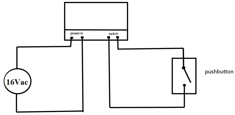

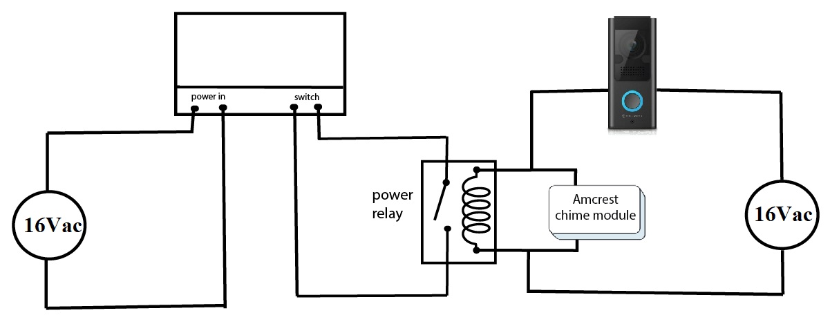

So because of the way I think this Doorbell works..
Again please confirm that without any wires on Com and Front there is no Voltage when you test using a Multi Meter from Com and Front. testing both terminals and then testing each with the AC terminals. If my thought is correct then here is what you would need to do to make this work
You will need a Relay. While you will be working with 16vac you can use this 24vac Relay
https://www.ebay.com/itm/144490363222?h ... SwbW1iTPoA
Then you will need to find what pins on the relay are for voltage and what ones are the switched. It should be marked on the relay or come with the Pin outs..
I think your system is like this. So in this it is setup so you know what I am thinking. Switch will be the Com and Front. and Power in is the AC/AC on your doorbell so I am clear This is what is going to be needed to make your doorbell work with the camera
