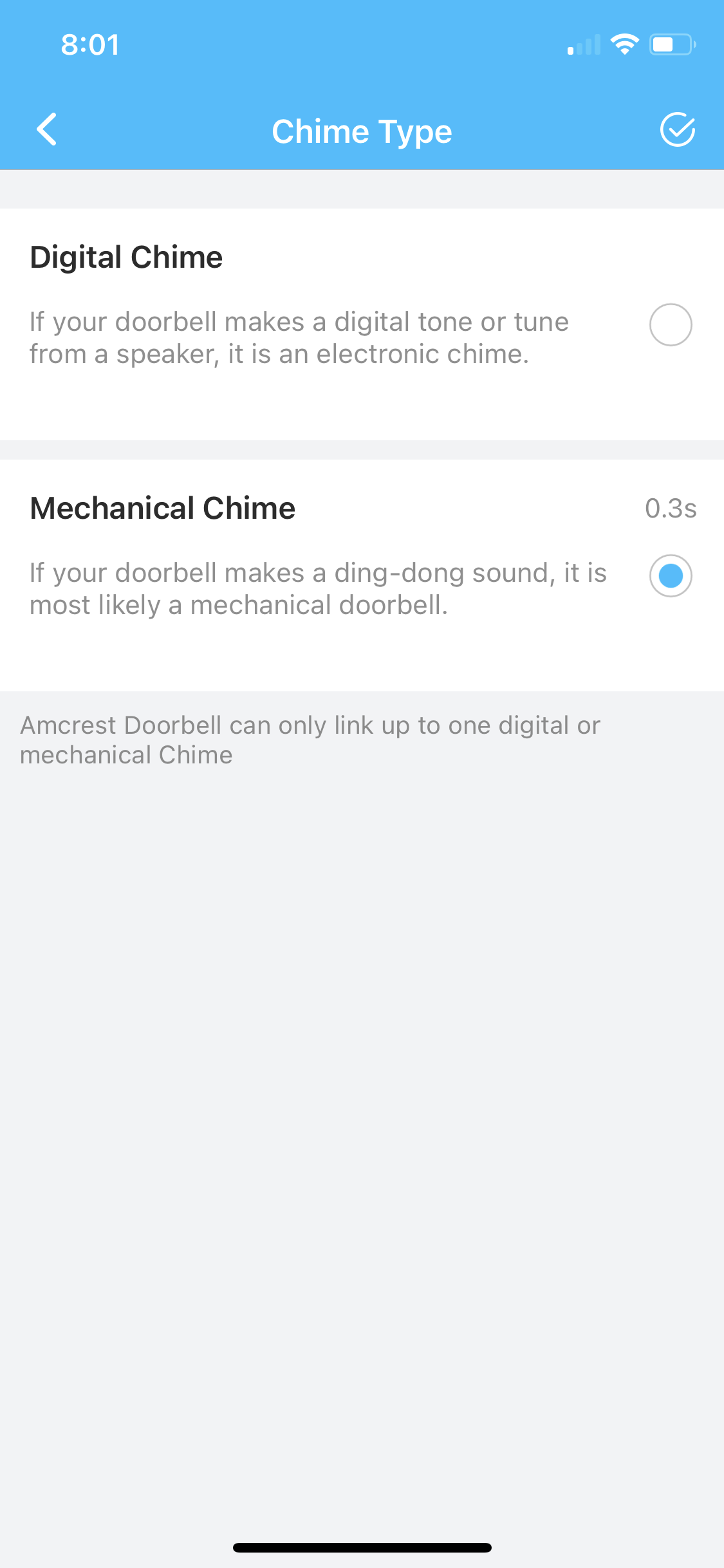

Screenshot attached showing .3 sec which triggers the mechanical chime.
I switched to the digital chime option thinking it may disable the signal to the mechanical chime and it doesn’t. It still rings.

@tmodlin , unfortunately it does not appear to be a current option. you can either post a feature request on this forum or submit a ticket requesting to add this feature for the next smart home app release if the feature is something the developers are able to include in future releases.
