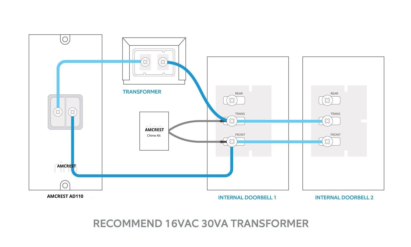

I have an AD110 connected to 2 mechnical chimes all wired to a new 16VAC 30VA transformer. I've also attached the included chime kit to the first mechanical chime. However, about 2 ago I noticed a humming noise from the 2nd mechanical chime. Until I find the resolution, I've disconnected the secondary chime. I was wondering, do I need a chime kit for the secondary chime as well? The wiring was done when I moved in and the previous owners used Cat5E 24AWG wiring connected to a regular (non-video) doorbell
I am including a diagram of my wiring (which I pulled from the ring website) but I think the same would follow for amcrest.

Hate to say that Ring and Amcrest cameras are not built by the same company and because Ring system might work ok with 2 indoor chimes I believe Amcrest has stated that the Doobell camera can only connect to 1 indoor chime..
Can it be done sure. Should it be done as the picture above no. The second CHIME should be connected to a Relay AKA Electromagnetic Switch.
Also 24awg wiring is to small for the Camera doorbell unless it is using a 4 on 4 wire to make it around 18awg.. Even at that it might not be right in 2 ways. 1 if it is not real Cat5E and if the length is too long
Re: 2nd Mechanical Chime Hum
wow that is some distance. I will guess that it would have to be Real Cat5E or there would have or should have already been issues at that distance.
Anyway markings on the outside of cable on fake cable looks real, and real way of testing is at the cable ends. Copper wire will be orange or copper color all the way even if you scrap layers off the cable. Fake will turn a silver color when scraped. Another way is fire test. If we think about Copper pipes in a house being used for plumbing the plumber puts heat to it with a torch (It don't damage the pipe well even with small wires real won't react the same way the fake one do (Fake ones melt away)
Main issue with CCA is that it has a higher resistance then copper and can make power supplies work harder then needed. Distance of wire even in good wire will cause the resistance of the wire to get higher. Taking a short piece of wire and checking the resistance of the cable it will be rather low. Take same wire add length to it and measure again and now the resistance will go up. With fake wire aka CCA that resistance is even higher and things change as the wires heat up and becomes worse..
Wires that are 24awg if added together would be better. I mean taking 2 24awg wires together would cause it to be 21awg and 3 19awg and as I said before 4 would be same as 18awg. At that distance even 18awg might be to little.. Remember we are working with Constant Voltage now running the wires where before the Doorbell Camera was put in place the voltage would only travel the wire when the button was pressed.
My guess is that your Transformer is going to be hot and would be interesting to know what the Voltage is at the doorbell. if around 200 feet of wire I would guess between 10v and 14v depending on wire size at 200 feet. on 24awg wire that would be around 32% voltage drop.
