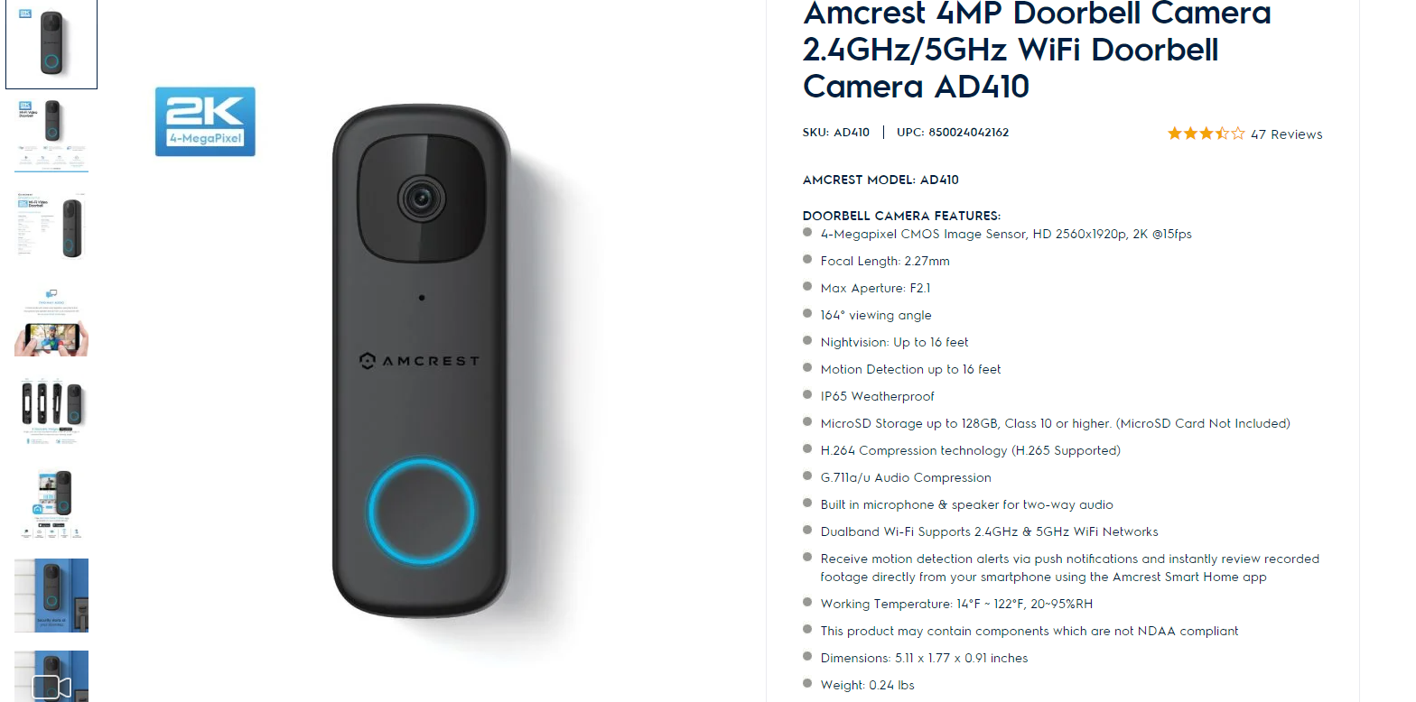

Re: [AD410] Lost the ability to RTSP video at 30 FPS
Awesome glad to hear you got the fw you wanted and the code worked for you now.. What is odd is that the listing still states it is a 15fps cameras.
Screenshot (1394).png (305.44 KiB) Viewed 6516 times
