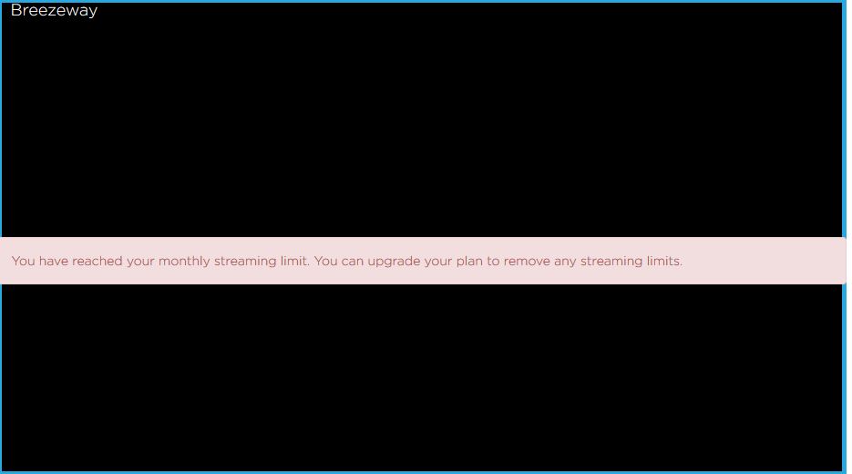

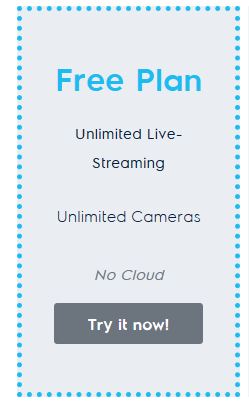

Recently retired my FOSCAM cameras and purchased a number of IP4M-1051B
using the cloud free plan which claims Unlimited Live-Streaming and Unlimited Cameras.
https://amcrest.com/cloud/#NewPlans
first issue: it is now claiming I have reached my limit for monthly streaming, despite the free plan claiming "unlimited" Are they using a different definition of unlimited than I am unfamiliar with? :)
Second issue: When I go to add the second camera I am told I have reached my limit for cameras. So, really, same question, different definition of unlimited? Has the plan changed but the page not been updated?
Thanks in advance for any help
Dan

Anyway I am wondering if the issue is that the account your first Camera was connected to was what was offered some time ago where it had cloud in that picture above it says no cloud... So I am wondering if the option isn't picked in the package settings right? Because from what it looks like from the second picture is this is from a Free Cloud limited to 1 camera...
So I am guessing this is a way to connect over cloud having to log into a website to view the camera over P2P.. I would just seeing this is NOT CLOUD as it says No Cloud in the listing and set up your cameras to use P2P and you can have all your cameras connected to your network able to work with Amcrest View Pro app on your Cell phone every where you go that you have data...
This will make it so youdon't have to worry about having your cameras Password out on some Website OVer your phone your app no one can easily hack your camera... They would need your SN and password to gain access however over a Website someone could maybe Hack the site and this in turn could gain access to your SN and password.. So I have removed my cameras from Cloud and the Amcrest view dot com website as well...

I'm using the https://www.amcrestcloud.com/ website to view the cameras. I ended up breaking down and calling support, which was very helpful. This was a "me" generated issue. Since I planned on getting the Amcrest cameras for a while, I had already created my account on the Amcrest Cloud website, even before I had my cameras. It would seem that the free unlimited streaming and unlimited cameras is a new thing, that post-dates my account creation.
All I had to do was fully delete my original account, and then recreate it. I now have both cameras on the account and assume that I won't be limited in my streaming either, though I won't know for a few days.
