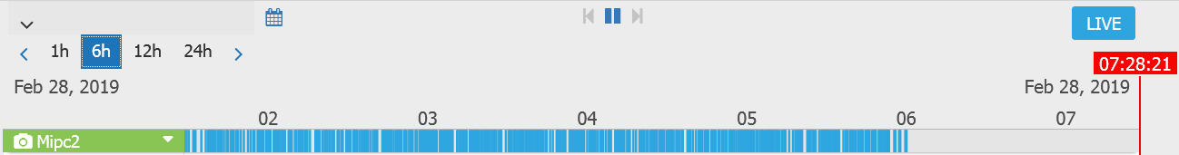

ok after looking at the recordings, it looks like they are apart by multiples of 30s like 30s, 1m, 2m etc but most of them are 30s apart and are 30s videos which is basically continuous recording.
I have attached the image of the cloud storage. I have put the schedule on the cloud to record from 9pm to 6am. There is only motion detect option at the cloud. This certainly does not look right.
There is no motion in any of the videos.

This has to be something to do with sensitivity/threshold setting.

This looks like it could likely be a sensitivity / Threshold setting that will need to be adjusted within the cloud and or the camera itself.
Please reach out to use (support@amcrest.com) The Team and I would be happy to work with you one on one to investigate why your camera is sending this amount of recordings to the cloud.
