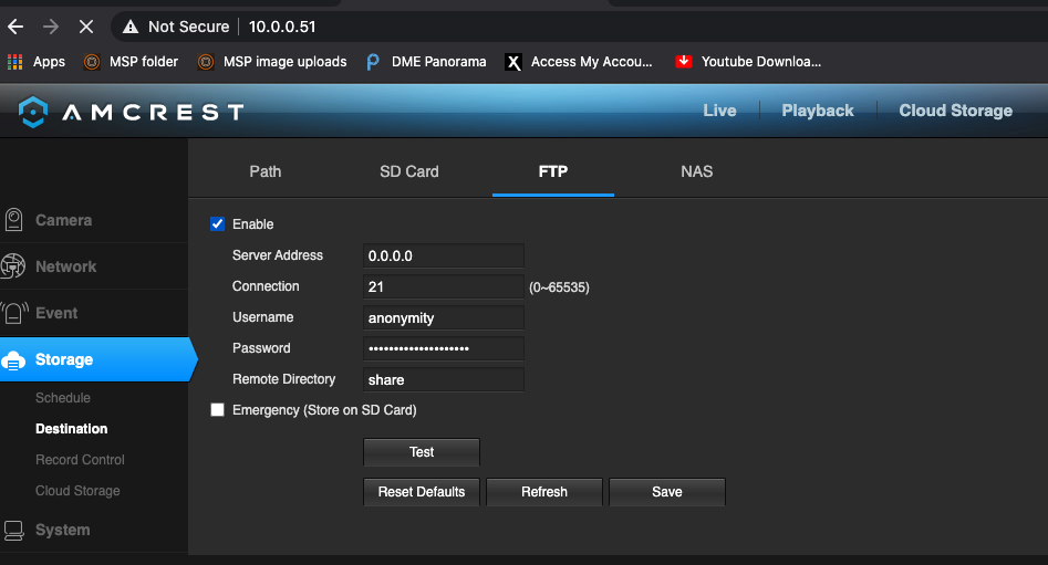

I'm in Storage > Destination > and I changed the path from SD Card to FTP.
Then, in the FTP tab, I check the Enable box and I need to supply and IP address. What should this be?

There nothing in FTP or SD card if you don't have FTP disable FTP and down to Cloud Storage 2 more icons under Destination is the icon you want to click on and then it will have you log into your cloud storage from that when you click on cloud. Then you put in the SN for the Camera on the cloud for that camera then it will have you finish the setup for being connected..
Just be mind full that the cloud if you make a ajustment it don't like it will change it back to what it does in the Encoding and also remember it is best to make the changes in the cloud not the camera..
Or just make sure you make changes in the cloud once you make the change in the Camera also in the camera logs in the past anyway the cloud will do changes and have nothing as admin or system being the person doing the change it will be blank..

To answer your question - you need an FTP server. One can most definitely setup a double "honeypot" and then install the server. Why so-because you don't want a damn bot to get into your network. Ports have to be opened and you don't want that.JParker wrote: ↑Thu Apr 01, 2021 8:49 am Hi friends,
I had been recording on SD Card. But I've encountered too many corrupt files and disk errors!
So I ponied up and I've just subscribed to a continuous recording plan on Amcrest Cloud.
But the error "The camera has cloud recordings disabled." appears at the bottom of the live view at https://www.amcrestcloud.com/timeline
So I figured I need to go back into my camera setup.
The other option is to purchase yet another cloud based ftp account. They will provide the needed information.
