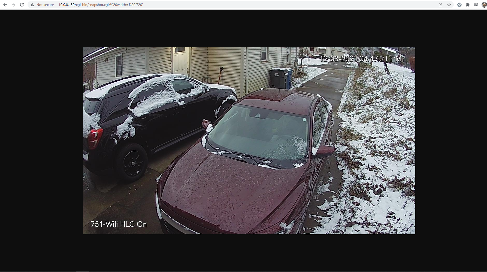

by Revo2Maxx
@jantman It all depends on the camera. I have a Old FW camera that it will work on so it really is FW related to what can and can't work. Maybe they are working in a older FW camera I just used it on my 751 over Wifi and it returned a picture
Screenshot (1604).png (1.62 MiB) Viewed 7872 times
