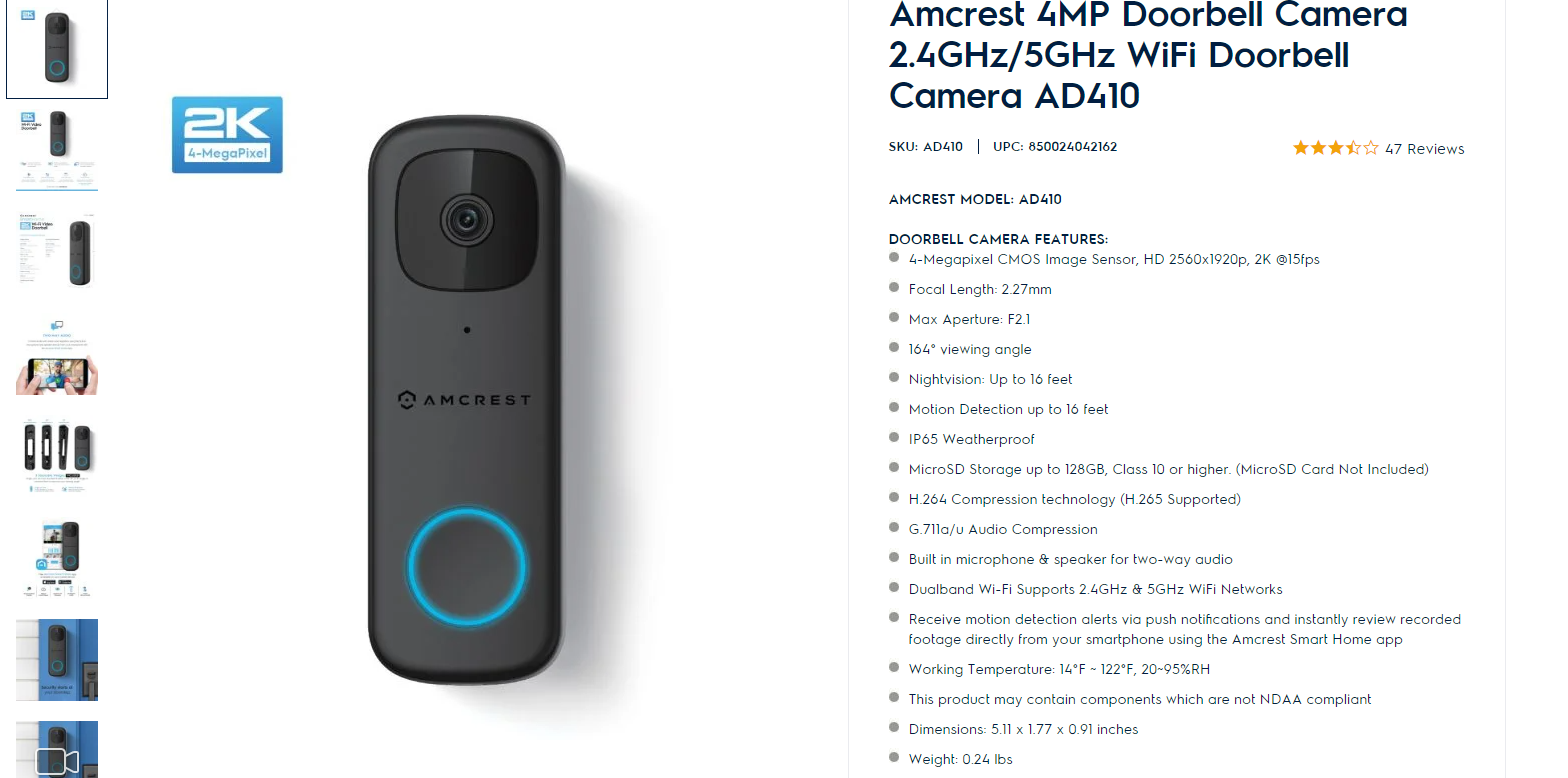

Awesome glad to hear you got the fw you wanted and the code worked for you now.. What is odd is that the listing still states it is a 15fps cameras.
Screenshot (1394).png (305.44 KiB) Viewed 6526 times

It's not odd at all. With either of the two currently publicly available firmwares the camera won't go above 15 FPS. I have to think that what's shipping with new units is one of those. You have to somehow acquire the very old firmware from almost 3 years ago to get 30 FPS.
