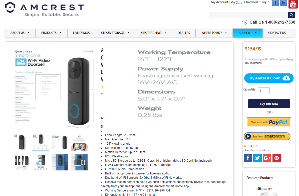

Well There you go.. I personally have not seen this.. Also someone sent something from their AD410 about power ratings and not sure where they got that info either seeing then Data isn't on my Box... Looking at the info above in your picture it looks like it is from the Data Sheet of the device from Amcrest.. I know that when I looked at it before I bought the device it wasn't listed like that before it said only AC16v to 24vac.. I did make mention that It can work with 12vdc and wonder if maybe it was updated after that because as I said before it only had AC voltage listed.. I do have plenty of DC power supplies I guess I will have to give it a try on one of my 24vDC supplies and see the power usage..
Personally I don't see the Data sheet anymore on my side. The data on the web can be hard to find.. However off the normal Amcrest Website Device page for the AD410 this is the blown up text of what it says on the website..
Screenshot (1072).png (317.66 KiB) Viewed 14074 times

Revo2Maxx wrote: ↑Sat Aug 21, 2021 12:35 pm Well There you go.. I personally have not seen this.. Also someone sent something from their AD410 about power ratings and not sure where they got that info either seeing then Data isn't on my Box... Looking at the info above in your picture it looks like it is from the Data Sheet of the device from Amcrest.. I know that when I looked at it before I bought the device it wasn't listed like that before it said only AC16v to 24vac.. I did make mention that It can work with 12vdc and wonder if maybe it was updated after that because as I said before it only had AC voltage listed.. I do have plenty of DC power supplies I guess I will have to give it a try on one of my 24vDC supplies and see the power usage..
https://support.amcrest.com/hc/en-us/ca ... 3132-AD410
and You can see Technical Specifications (AD410)
If you open this pdf, you can see power input
