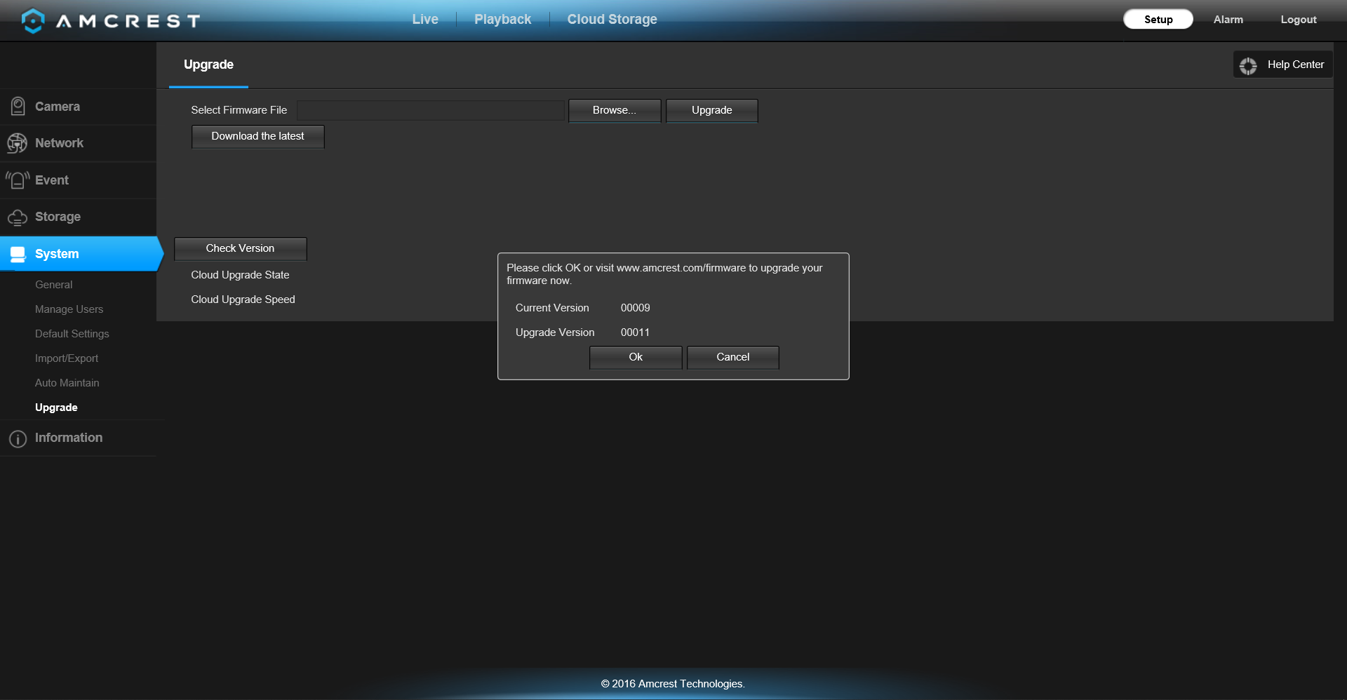

So here is one of my cameras that hasn't been connected or updated since 2016 and this is what it looks like for update from cloud...

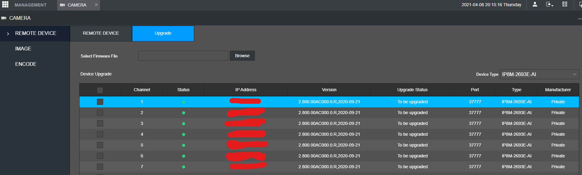

The UI of my NVR is a bit different, but no popup appears.
The FW seems quite recent, but NVR is popping the "camera is upgradable" comment.
Don't know hot to attach snapshot.

This is the page shown on device status.
Screenshot 2021-04-08 202010.png (65.75 KiB) Viewed 660 times

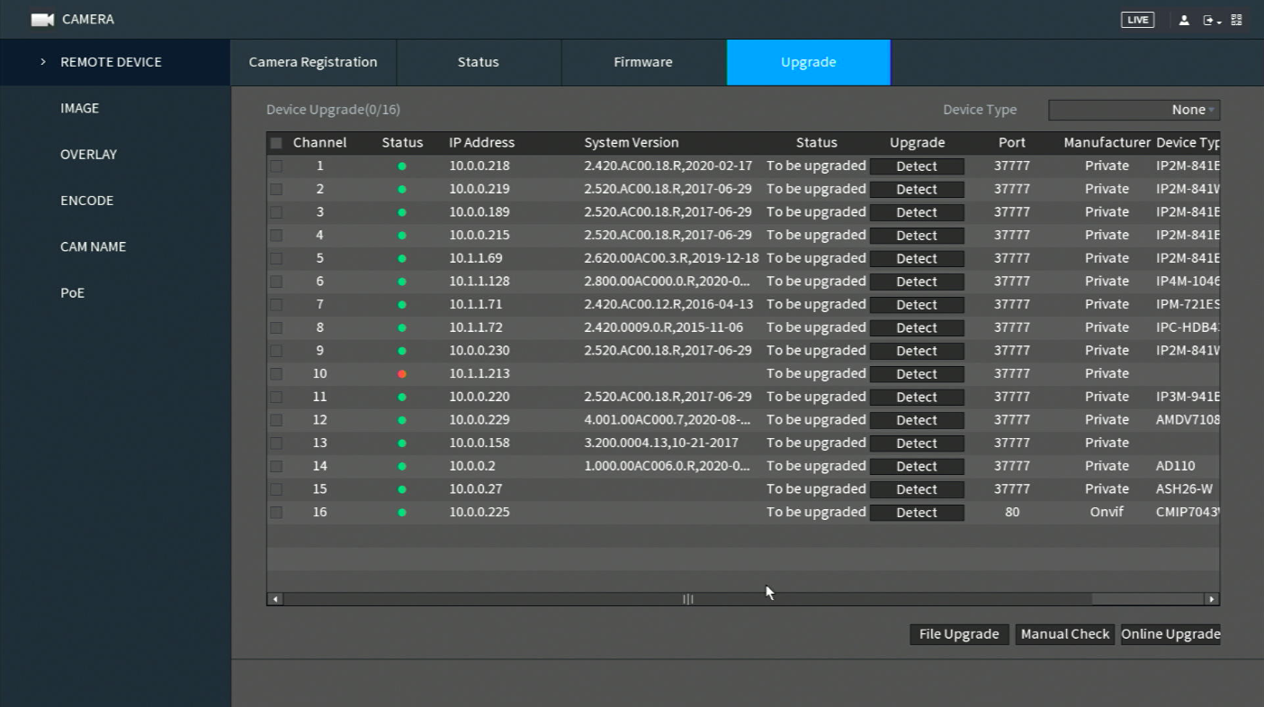

OK sorry that was looking at a picture of a camera showing what it would offer if there was an update... here is the NVR.. And yes I have a Remote camera offline until my son can get to the other house and Reboot the camera after he gets off work I would but I am far from it..

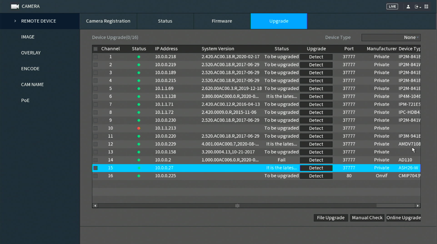

For your AI camera or any other camera if there isn't one on the website and it is a NEW camera like your AI is then there isn't one.. IF you look at my Second Picture after I click the Detect you can see both pictures have same FW yet the top one says what yours says...
after pressing detect

by mtg
I don't have the "detect" button, even on ActiveX version.
