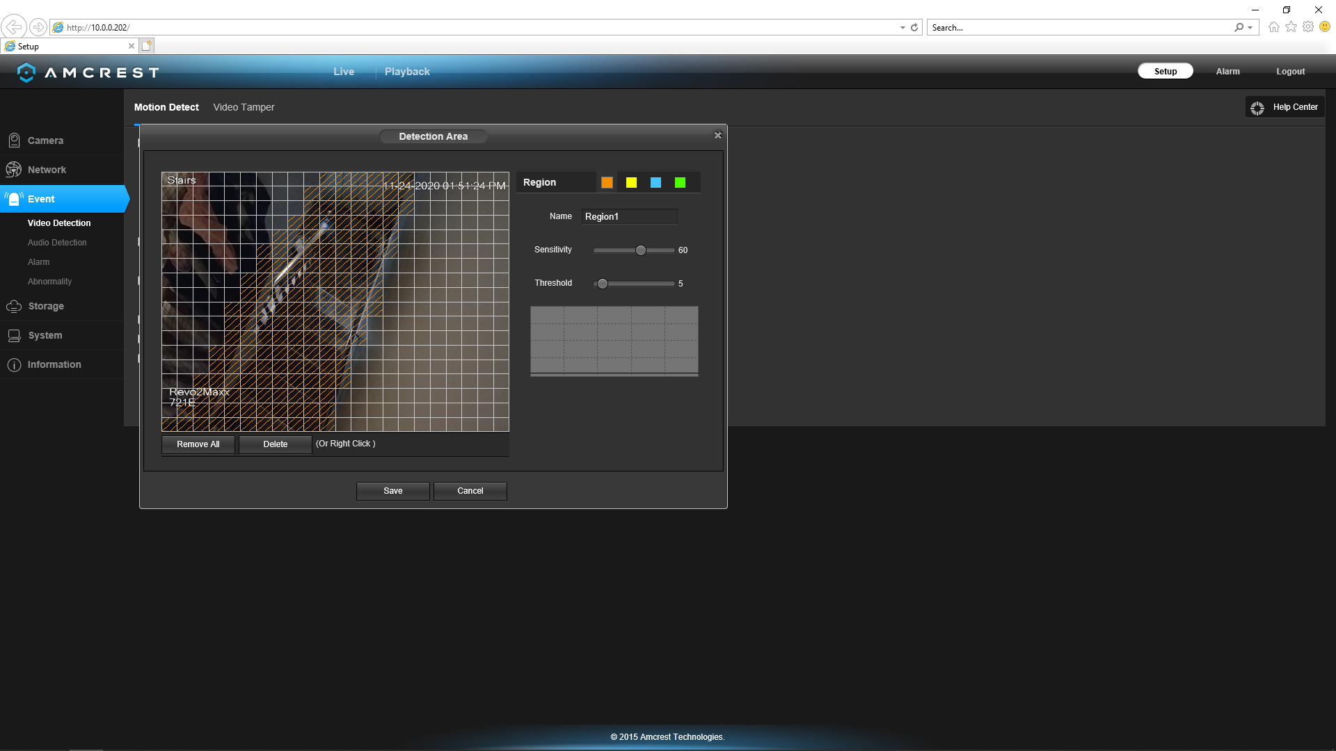

I have a 721 that I have on my Stairs, It detects going up and going down.. I have it setup to record 120 after last movement and 5 seconds per.. IT has been very stable sadly it is POE so it is not on a newer FW and is on the last FW that it has been offered.. SO my 721 being a POE might be different then yours if it is on a newer FW..
I would personally try and do a Reset of the camera and leave the Threshold and Sensitivity as it was after doing a Reset.. Then I would setup the Grid for your needs with only 1 option for motion
I would give that a try and see what happens..
Here is the Version I am on 2.420.AC00.12.R, build : 2016-04-13 as I said it is a POE 721 and that is the last FW that I found for it online..
Screenshot (201).png (393.52 KiB) Viewed 258 times
