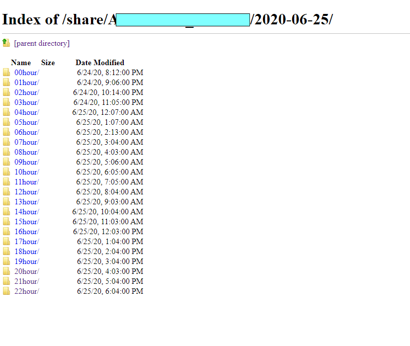

Funny thing is I just looked at my Folders and wow lol... Camera time is set per the NVR and time shows right time but in FTP folders they are off a few hours starting at 8pm I never paid attention to that until now lol... Anyway.. All I care about is the footage being backed up.. I was sending to my Webserver FTP for a little while and it was off by a day so this is better then the whole day... Now I just FTP into my Webserver footage I want to keep longer offsite...
