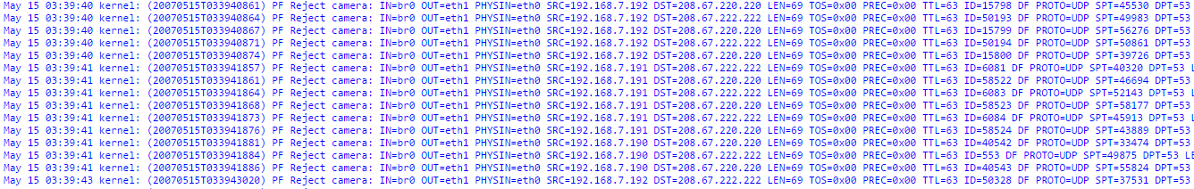

i didnt want to paste a ton of spam, but i'm well beyond the 2 hour window.
19:21:39.917645 IP 52.91.189.219.8802 > 192.168.128.51.43211: UDP, length 28
19:21:46.799666 IP 54.88.9.177.443 > 192.168.128.51.38103: Flags [P.], seq 1339879989:1339880046, ack 4086784577, win 259, options [nop,nop,TS val 570156962 ecr 83040], length 57
19:22:00.828865 IP 52.91.189.219.8802 > 192.168.128.51.43211: UDP, length 28
<truncated>
19:29:43.074343 IP 52.91.189.219.8802 > 192.168.128.51.43211: UDP, length 28
19:29:46.748735 IP 54.88.9.177.443 > 192.168.128.51.38103: Flags [P.], seq 1339880901:1339880958, ack 4086785537, win 259, options [nop,nop,TS val 570276965 ecr 131039], length 57
<truncated>

Re: Constant Attempt to Connect to Dan Burkett
Just a "me too" on this. I installed my first 5 cameras about 10 days ago. I am not using Amcrest Cloud. I noticed today that there have been nearly 6000 DNS requests to resolve config.amcrestcloud.com (logged by my DNS provider)
I then set up a firewall rule to block outgoing connections from the cameras. There are actually about 5 DNS requests PER SECOND, PER CAMERA from the 3 IP2M-841B cameras (indoor pan/tilt zoom cameras). Interestingly, the 2 IP2M-842B cameras (outdoor bullet cameras) do NOT seem to generate these outbound connection attempts.
I have attached a screen shot of a partial log from my firewall...just for 2 seconds of activity. The 3 cameras in question are on 192.168.7.190, 191 and 192.
This seems to me to be a fairly serious problem with the IP2M-841B cameras running the 2.420.AC00.17.R, Build Date: 2017-03-22 firmware. (I do not know if older builds of the firmware have the same behavior.)
- FWLog.PNG (97.89 KiB) Viewed 1714 times
