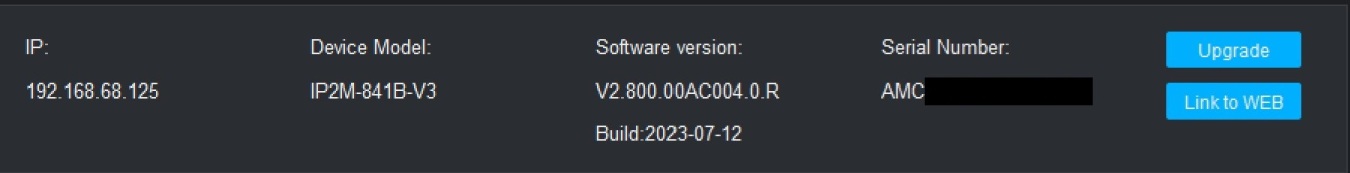

You're saying that when you click on a camera in the Device CFG group in ASP for iOS, you do not get the "Link to Web" button?
Screenshot 2024-10-04 202234.jpg (35.34 KiB) Viewed 10387 times
